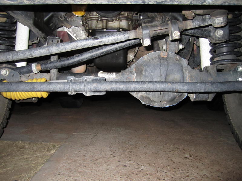

anything wrong with the track bar here???

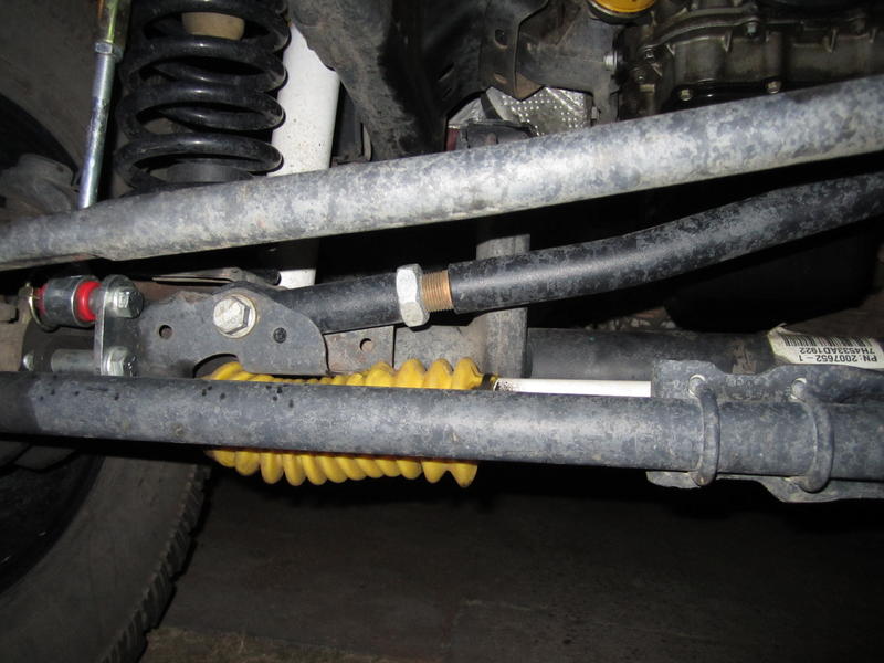

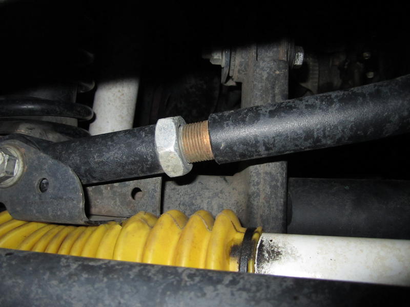

Looks.....loose???
Old Jan 20, 2011 | 06:08 PM
Robar's Avatar
Joined: Nov 2006
Posts: 15,170
From: .
Jam nut on the wrong side?
Old Jan 20, 2011 | 06:12 PM
Biggy's Avatar
Joined: Apr 2009
Posts: 2,124
From: Ontario Canada
To many threads showing.
Old Jan 20, 2011 | 06:14 PM
JK.nick's Avatar
Posts: 1,433
From: Flowery Branch, GA
Yep, looks like your jam nut is loose. This may cause DW, as mentioned in this thread:
https://www.jk-forum.com/forums/show...t-death-wobble.
jrylb73's Avatar
Posts: 204
From: Granby, MO
X2 jam nut should be all the way to the other side, right now it is loosened all the way.
Old Jan 20, 2011 | 06:18 PM
maroon jk's Avatar
Posts: 207
From: Albuquerque, NM
yes!!! just seen it now! it is was loose! :( and i had DW today too! so first thing tomorrow morning i am gonna tighten it! it should be tightened to the other side right????
Old Jan 20, 2011 | 06:20 PM
jrylb73's Avatar
Posts: 204
From: Granby, MO
Yes sir, you are right. Righty tighty, lefty loosey.
Old Jan 20, 2011 | 06:23 PM
Robar's Avatar
Joined: Nov 2006
Posts: 15,170
From: .
You may have a couple of problems. Jam nut should be up against the long side of the track bar to keep the joint from moving after it is set to the correct length. It also keeps the joint in position and reduces the vibration on the threads. If the jam nut has been loose for long you may have some serious wear with the threads both on the male and female side. This could prevent the jam nut from being able to support the threads and cause a catastrophic failure in the future.
Old Jan 20, 2011 | 06:34 PM
maroon jk's Avatar
Posts: 207
yeah thats true! well thanks for all your help hopefully good bye to DW!
