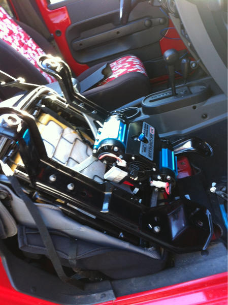

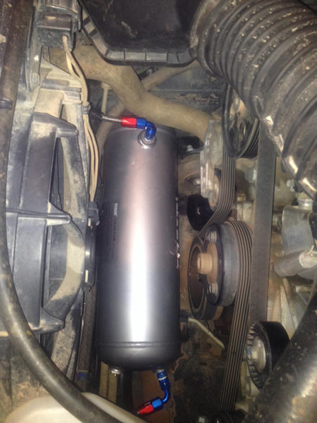

I installed an ARB Twin using a Carolina Metal Master under seat mount. I also added a Viair 2 gallon tank using a synergy mount that mount the tank between in the engine compartment. I used PTFE stainless braided lines and Aeroquip 3/8" to -4 AN fittings and Summit Racing Hose ends. The install took 2 days, you have pull the battery tray to run the ARB power and airline to the engine compartment. That said, if you have ANY interest in a dual battery setup this is the time to do it.
