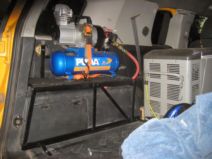

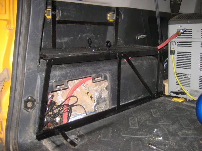

Hey all,
I still don't even have a Jeep yet, (life got in the way) but I am decided on the 2011+ 4door Rubi.
In my research, I do know that I will want a compressor and tank for airing up, stocking the campfire lol etc.
This is a plan Ive thought about even went to the dealer today to check out the cargo area, I think it can work.
Yea, I know, this is a Toyota FJ, please forgive me lol
I know this will need to be tweaked a bit for the JK, but the basic idea is the same.
