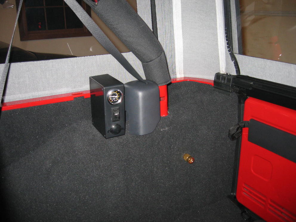

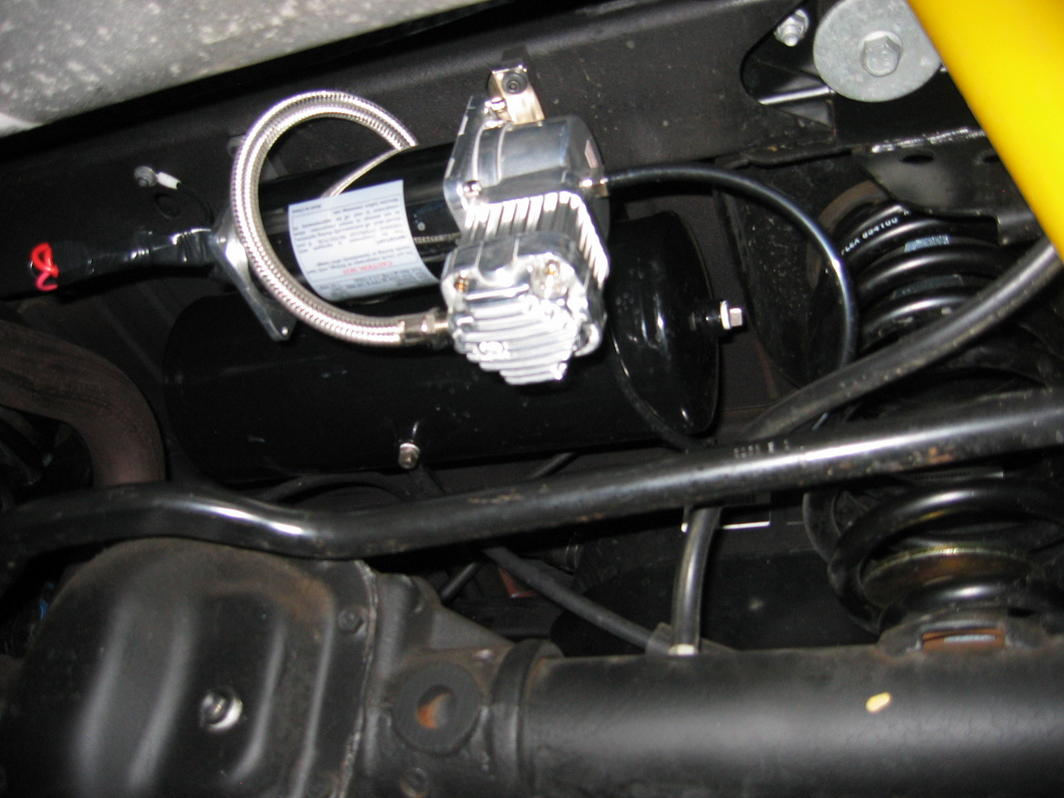

I mounted my Viair constant duty compressor to the rear cross member behind the rear axle. I also mounted a 2 gallon tank to the bottom of the tub above the rear axle. I then made a custom enclosure that contains the guage, pressure switch, power switch and I also added a 12v power outlet. I originally wanted to mount the compressor behind the tail lights but this compressor would not fit. I like having the tank since it gives you an instant 150 psi burst of air plus it keeps the tank under pressure while moving from tire to tire. Let me know if you have any questions.
Pics attached.
Name:	113_1392_Control Panel.jpg
ID:	31573   Click image for larger version
Pics attached.
Nice Install!! always like to see good quality installs. If anyone has any questions feel free to PM me.
Sean
