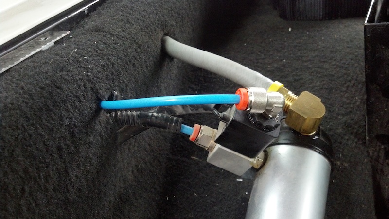

Did mine here and put a cover over it .
Exhausted the breather on the solenoid outside to vent any gear oil vapor out.
If you run lockers off of it vent the solenoid outside, I talked to ARB and gear oil small amount in line is normal. It will spew a smidge when disengaged.
