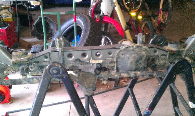

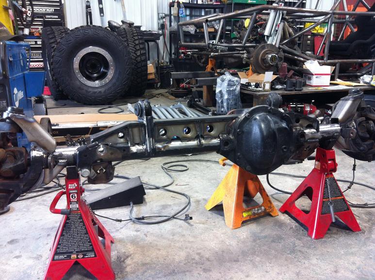

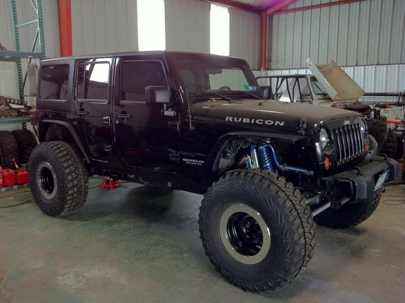

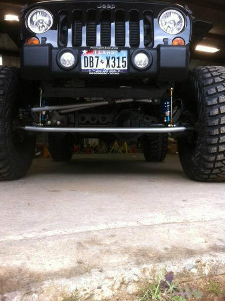

I have the Artec front truss, C-gussets, and LCA skids on my dana 44 with 38's. So far so good. I do have plans of 9" axles though cause I'm gonna beat the snot out of my rig

Old Nov 29, 2012 | 08:43 PM
VETTETHRET's Avatar
Joined: Dec 2009
Posts: 959
From: Irvine
Attachment 393520
Attachment 393521
Attachment 393522
Attachment 393523
THAT is a bad ass rig! You arent kidding, that thing looks beefed up!

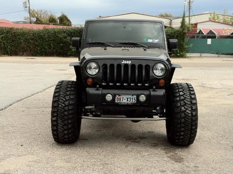

I also went with the artek truss & C- gussets, track bar bracket
Nice piece fit well, customer service is great.
Old Nov 29, 2012 | 08:58 PM
dhubers's Avatar
Posts: 52
From: noble Ok.
Another pic.
Old Nov 29, 2012 | 08:59 PM
VETTETHRET's Avatar
Joined: Dec 2009
Posts: 959
From: Irvine
Originally Posted by dhubers
Another pic.
Attachment 393529
Excellent! Thanks guys, I will order these up.
