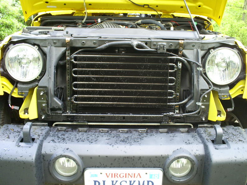

I put the 26000 GVW cooler on my Unlimited about 20 months ago... no issues. High speed highway driving, some beach sand driving ( 10 miles one-way in loose sand ) NO issues, no auxillary fan, if it makes you feel good get the fan.
Name:	tranny cooler 004.jpg
