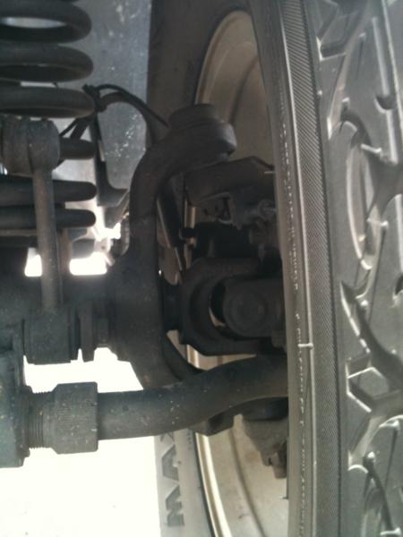

So, I think my axles C's are bent. Anyone want to confirm this for me. I bought my 08 X with 34.5" tires and a 4" RC lift.
Here are some pics:
Driver side:

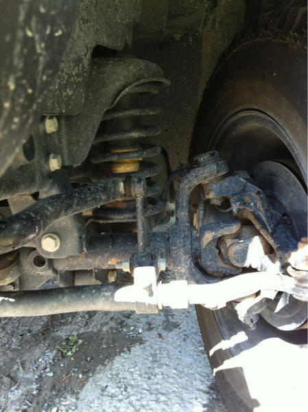

Passenger:
Anybody have a solution? New axle is probably out of my price range at the moment...
Thanks for any help.
Old May 11, 2012 | 10:33 AM
rb1boxer_3's Avatar
Posts: 665
From: corpus christi, tx
I think that's how they look. Cause I have a brand new jeep and they look like that.

Old May 11, 2012 | 11:14 AM
the_cuse420's Avatar
Posts: 551
From: Fayetteville nc
Those are stock sway bar links and u have a 4in lift u might wanna get that fixed first. The c gusset look fine though
Old May 11, 2012 | 11:28 AM
river2c's Avatar
Joined: Jan 2009
Posts: 722
From: Carlsbad, CA
You need to have an alignment done to check if the camber is within specs. If it's OK, I would get some c-gussets welded on before they do bend.
Old May 11, 2012 | 11:45 AM
williard86's Avatar
Posts: 159
From: Mobile, AL
Ha. Arriving today actually! Thanks though.
As for the gussets though, that's kind of why I was wondering and looking at them. I didn't want to try and gusset a bent axle. I'll get an alignment done this weekend. Thanks guys.

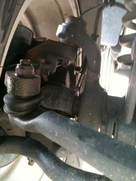

Old May 11, 2012 | 01:47 PM
rb1boxer_3's Avatar
Posts: 665
Not bent c's
