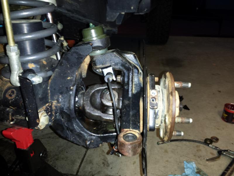

Installing a set of Nitro chromoly shafts today and can't get everything back together. I have evo sleeves and I think the new axles are too thick. I can't get the unit bearing all the way on. Anyone know if these 2 components will work together?

I do know the nitro axles won't work with the after market axle seals. I bought a set of the end if the tube seals and they would not work with my Nitro Axles. They are bigger than factory

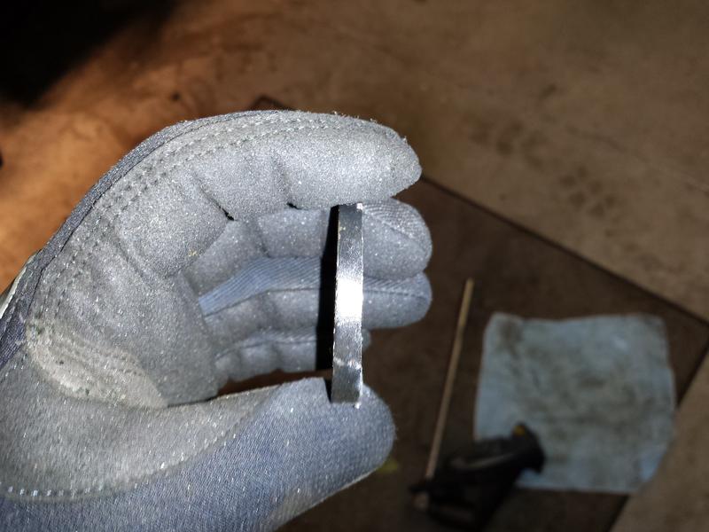

Difference in axles

I go to put the stock axles back in and look at the gap. I don't see why it won't fit. I must be missing something.

Measure your axle shafts,by the picture it looks like your up graded shafts are longer
Old Oct 27, 2013 | 02:56 AM
OH9JK's Avatar
Posts: 3,796
From: Stokesdale, NC
Do you have any extra sleeve sticking out?
Old Oct 27, 2013 | 03:59 AM
Invest2m4's Avatar
Joined: Jun 2013
Posts: 3,697
From: Grosse Pointe, MI
What spline axles are they? Upgraded 30 spline won't work with sleeves, except the nitro sleeves.
Old Oct 27, 2013 | 04:18 AM
Tylerm78's Avatar
Posts: 218
From: Louisville
They're just 27 spline. They engage in the ARB just fine. The shafts are the same length. There's more material on the yoke though. I'm going to attempt to trim sineish the EVO sleeve to get them in. Hope that works.

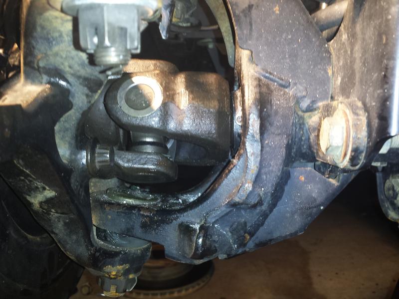

Well got back to figuring this out. Trimmed off about a 1/4" of the EVO sleeve and they fit perfectly.
