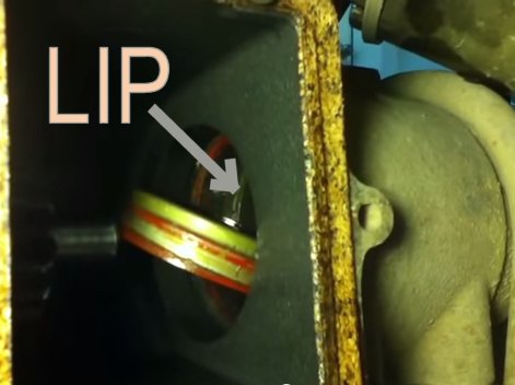

This is off a TJ D30. The seal seats against the lip exactly as it does in a JK D30. I'll be surprised if a JK D44 is any different. I can't imagine how you could properly seat the seal if there's not a positive lip to press it against ...

You're right ... Here is a pic I just snapped now that a seal is out.
There is a transition but it's back pretty. I am going to try later with a used seal. Honestly, I don't see the seal going in that far unless that's where it's supposed to go?
I can not find any pics of a Jk/front seals.
Attachment 574964
Yep... Exactly my thoughts. Crap... I will
Measure later on.. DUH.. Never thought about it.

I think you'll be in good shape with the Yukon tool.

Interesting find
Looking at the seal I removed and new Mopar seal, there's a difference between the 2
The radius in the middle is not tight (or coined when pressed)
From the back side, a socket/press can't center on this surface. It rocks back and forth. Explains why I had a hard time keeping the press straight.
Wondering if this seal was manufactured in-correctly.

Update:
Received the yukon tool yesterday, also had something put together at work.
Using the original seal and the DIY press, I was able to knock it in flush... Worked pretty good actually. Then with the Yukon press i pushed it in further. This time a 1/4 into the axle and there was nothing there to seat it.
Just kept being pushed in future and further.
That answered my question
Popped that seal out and tried the new one. The one that was crooked .050 or so.
Again .. Used the DIY tool to sit flush with the tube. W/ the Yukon tool a bit past the chamfer. Looks to be maybe .020 but doable.
If I don't receive the new seals I ordered TODAY ..this one is being run. I just don't see them going in absolutely perfect is even possible.
