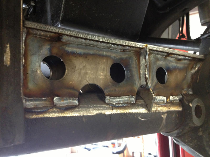

Artec makes an awesome truss!! It's a must have for any axle!!

Originally Posted by rubiconjk09
<img src="https://www.jk-forum.com/forums/attachment.php?attachmentid=471778"/>
That looks great. Definitely adding it to my must haves.
