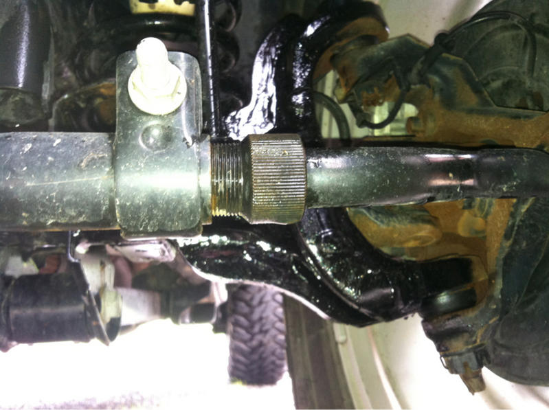

Got my upper and lower C's welded with the gussets from Pure Jeep.

From: Clarksville, TN
Is it just me, or is that "C" bent like crazy??
-Adam
-Adam
Not sure how it could be, those gussets are .75" plate and cut to fit exactly that shape and they fit perfect
Old May 20, 2012 | 02:10 PM
D_engel's Avatar
Posts: 2,539
From: Tempe AZ
looks fine to me..If your looking to sell the truss itself now, shoot me a PM. Im in the market
