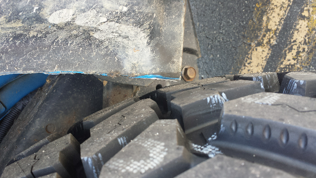

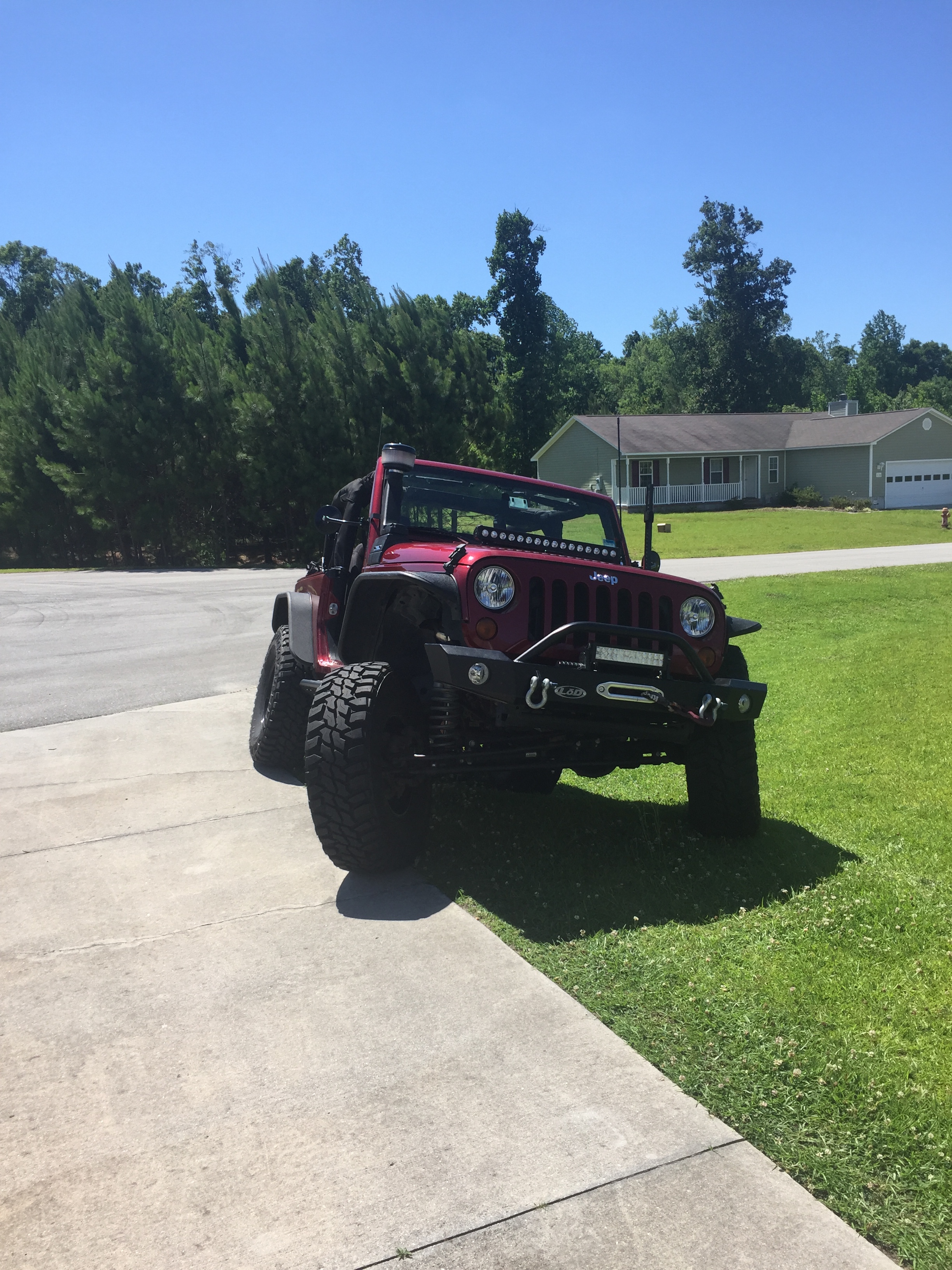

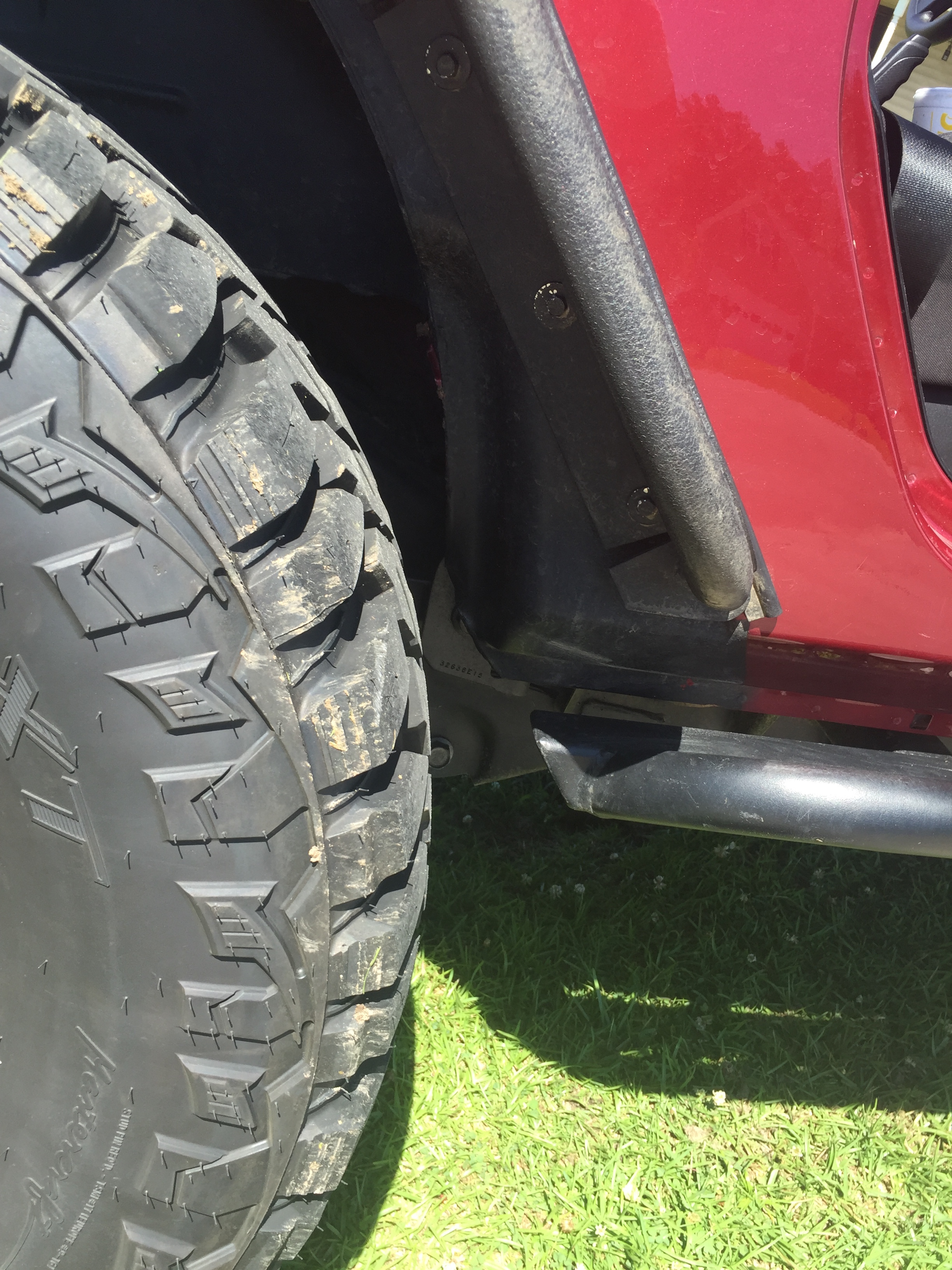

I have rubbing on my Mid width bumper ends when I'm disco and flexed. Probably going to mod it by cutting it down. I have 37X12.50X17 and 4.5" back spacing.

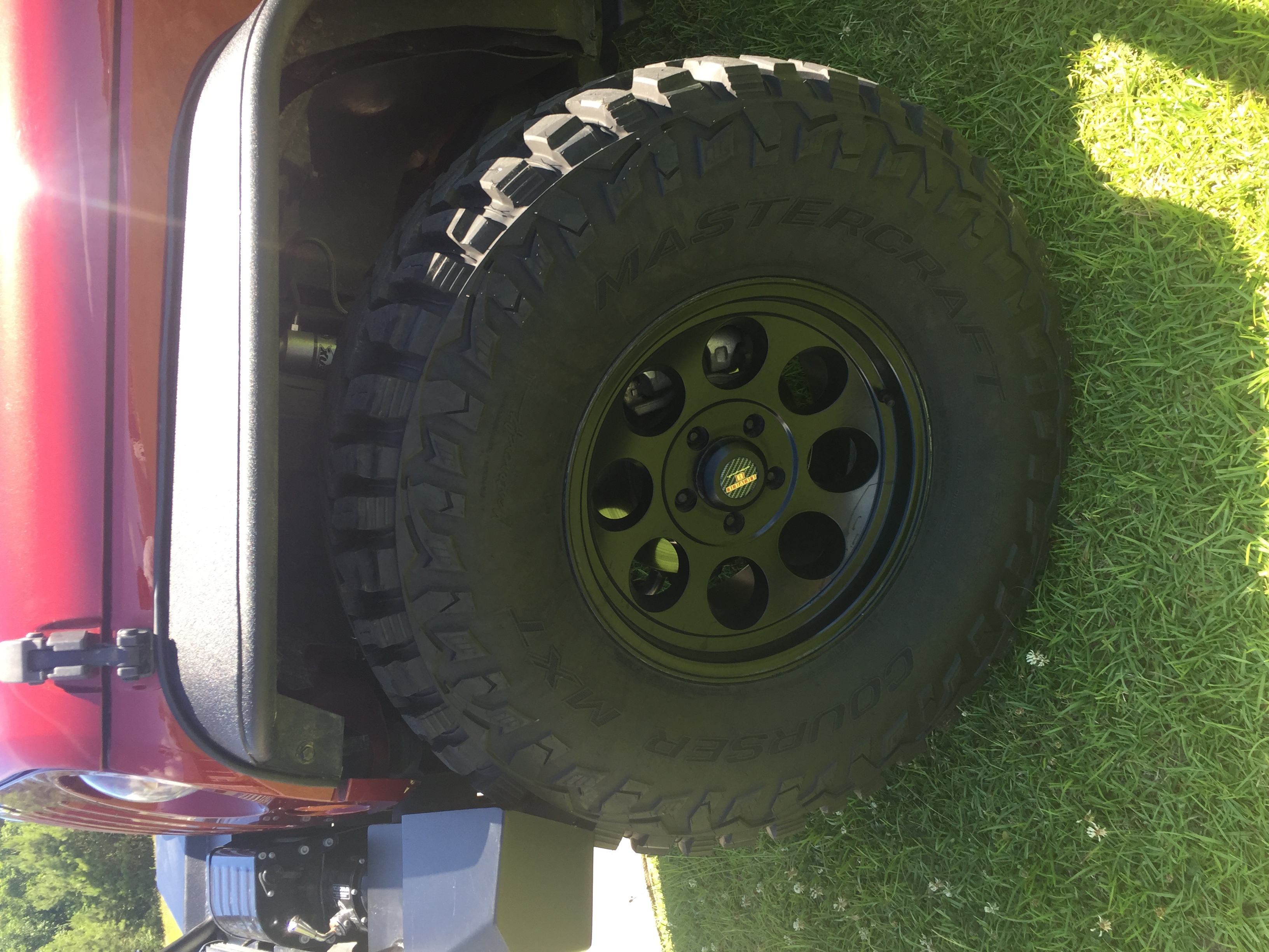

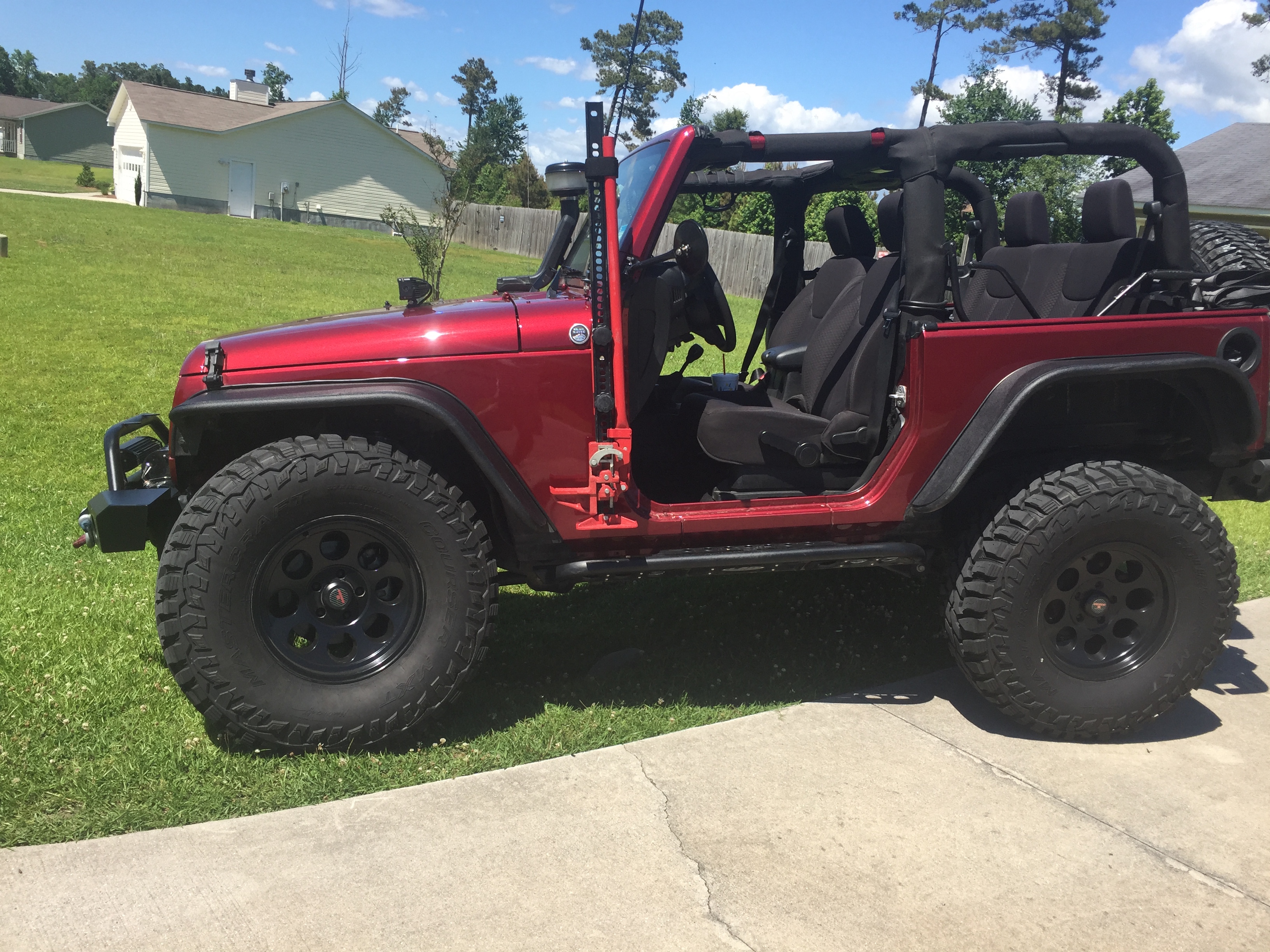

Originally Posted by Boosted
Need more info to properly answer your question....
Like what ? I have a 3.25 rusty's lift. Stock rims and 1.5spacers. As of now.
