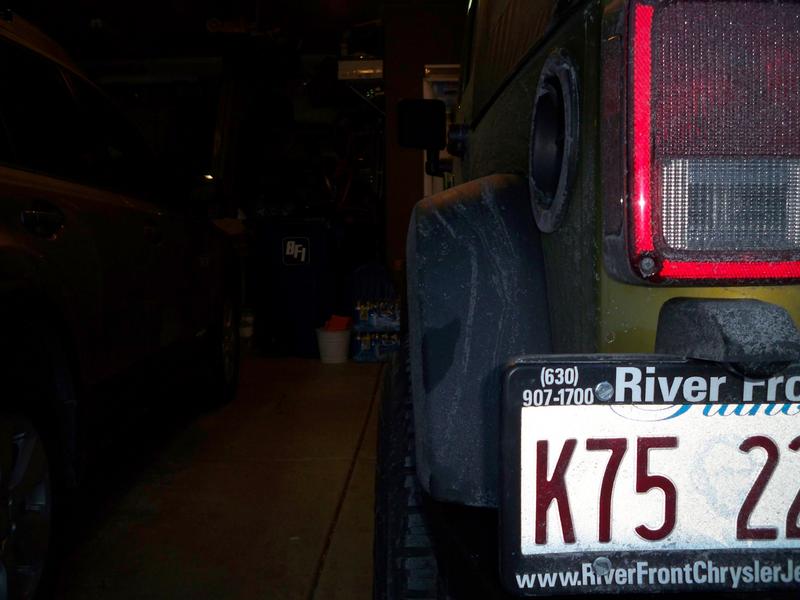

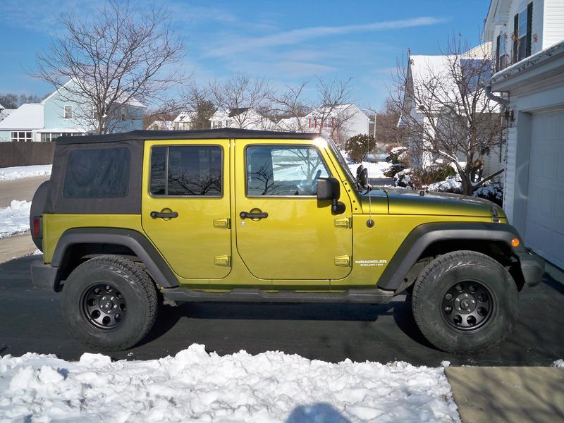

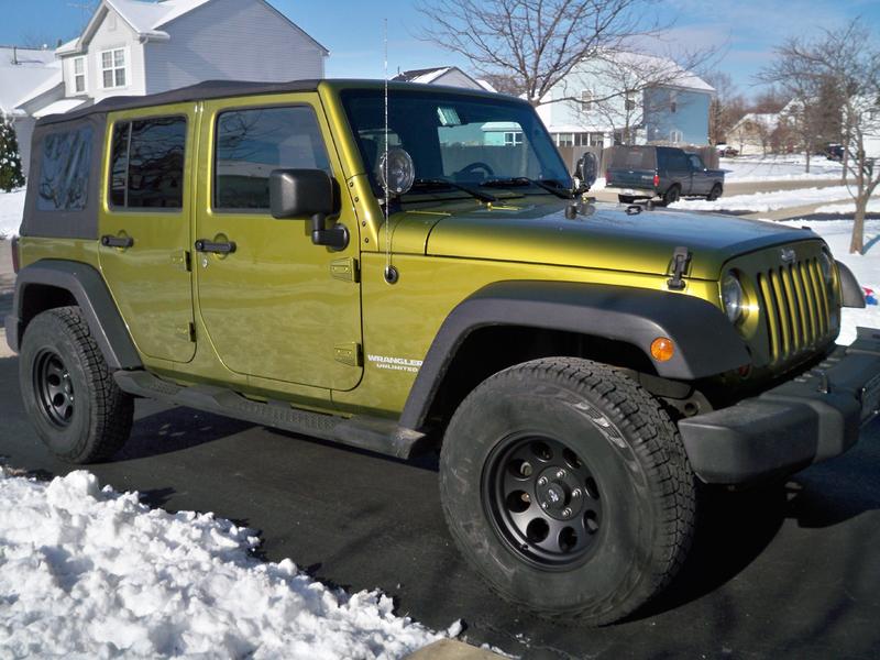

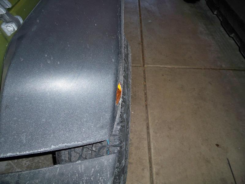

Sorry for not attaching link, I don't know how to do that from the mobile app. Here are a couple pics for you. i'm running 285/75/16's on stock suspension...for now

Good point! I forgot about that. You are correct about the 4" BS on the 7069's. I could swear that at the time I ordered these I had 3 options 4, 4.25, and 5. When I went back to look them up again I could only find 4" & 5, so I dbl checked my invoice and 4" it is. Only important to me bc I still have a spare tire to replace. Note: 4.25 will not stick out as far as the pics I posted...FYI to those who struggled with this concept like I did at first... BS vs. Offset and so on.
