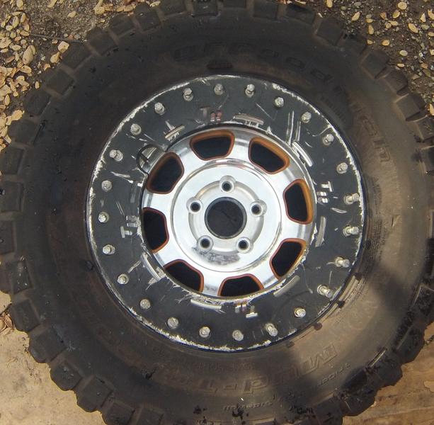

Never had to use them on either set running 35's in KM2's or Mickey Thompson's...
TrailReady's after I stripped and repainted the wheel....
ID:	633005Click image for larger version
Raceline's when I want to change things up....
