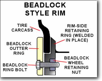

So let me get this straight. The wheel has a high lip/ridge inside and the bead lock ring I see clamps to it and sandwiches the tire edge/bead effectively locking it in place to prevent it from slipping off the wheel?

this should give you a idea

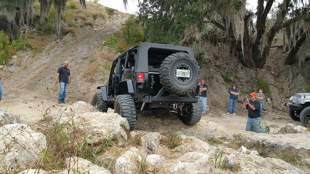

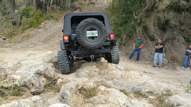

I run trail ready beadlocks and 35's and have found that I can get over stuff like larger rocks because of the expanded foot print when I am at 8psi.
I was at 10psi during this run...

I have minimal maintenance and I am able to mount the tires myself and only have to have them balanced which I do myself at my buddy's shop.

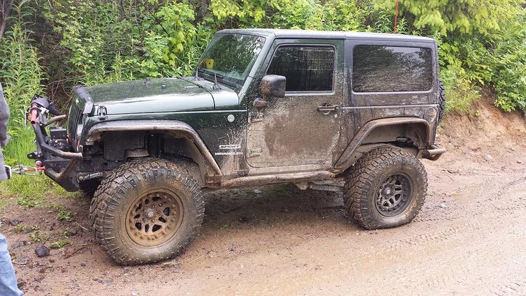

Hutchinson Rock Monsters - approx $400 and change each.
They are very stout, do not need a ton of maintenance, and can be done at home.

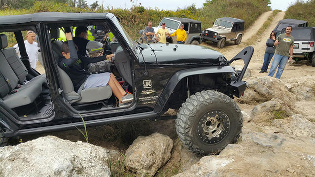

I am currently running spyderlocks and like them. I have friends that run trail readys and swear by them. Honestly if you get any reputable brand you will be fine.
