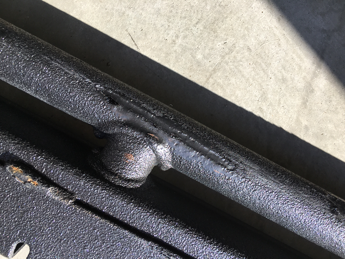

Hey guys, anyone know how to remove bed liner? I picked up a pair of rubicon enhanced rock rails the other day from some guy off Craigslist for nearly nothing. However, the knucklehead decided to coat them in bedliner and it looks like garbage. I'm planning on getting them powder coated, but am not sure if bed liner spray can be removed with the usual sand blasting process performed at powder coating shops. I've emailed a few shops, but nobody has gotten back to me yet. Anyone able to advise? Thanks in advance.

@Larry0071, I agree to an extent, but I also believe in having some sort of aesthetic to the jeep, as it is a daily driver which sees some trail use on the weekends, not a dedicated rock crawling trail rig. Secondly, the bed liner was done extremely poorly with two types of liner and not sealed well, resulting in rust developing beneath the coating all over the place. Even if the bed liner was something I wanted, the current coating would still have to go and the rust blasted off before re-coating the metal to prolong the life of the rails' structural integrity.

Those pictures... you call that rust and a bad coating? I see a gouged area and a rubbed clean weld with the lightest hint of surface rust... hardly in need of cleaning or blasting. Rust can not magically continue to grow once you hit that with some bed liner.
If that bothers you, by God!... do not go offroad! Do not ever go someplace that you may need rock rails! By the time you hit that rock rail, your diffs, axle housing, control arm brackets and tie rod will look like they were beat with sledge hammers. Now I know for sure... you have rock rails only for the esthetics.
Hint: Rust can only grow with these three things as a minimum.
1) A susceptible material. You have this.
2) Oxygen (Removed when properly spray bombed)
3) Moisture (Blocked when properly spray bombed)
You can add more to accelerate the process, such as a corrosion accelerant such as an acidic product.
You can have the most rusty POS junk ever seen, and if you knock off all loose scale (that entraps moisture and oxygen) and coat with a properly sealed paint or other coating.... you break the process. Unless we re-write our basic understanding of the chemical properties and processes of corrosion to fit an agenda (think of how Liberals do similar), the truth remains.
