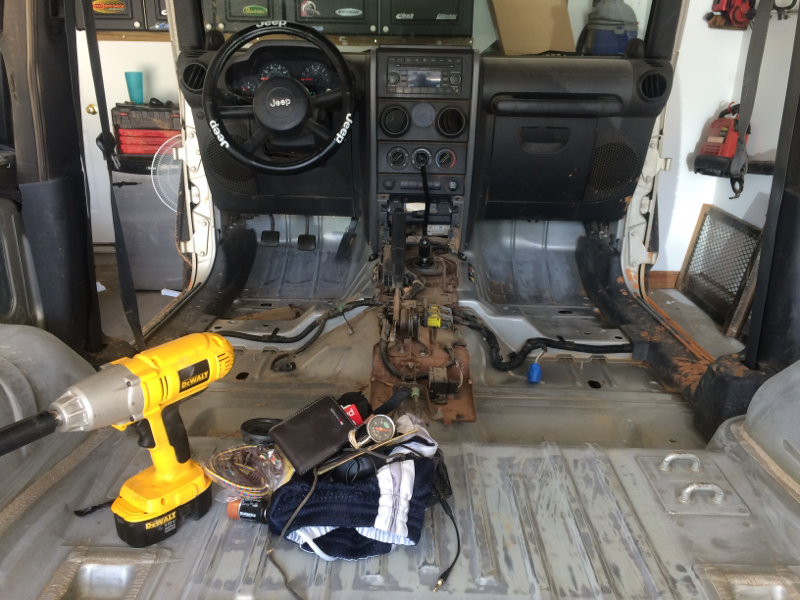

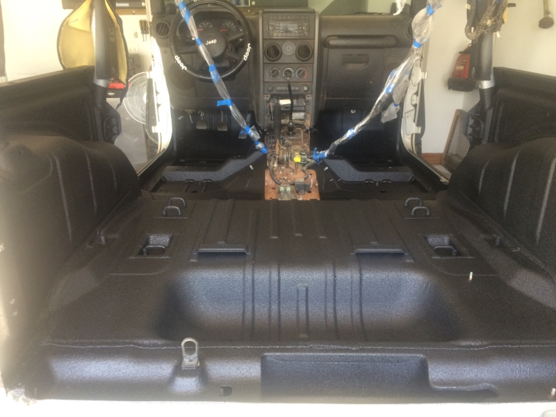

Sprayed my tub last Sunday with Raptor Liner. I love it so far. There are tons of write ups on this just google "jeep jk raptor liner". The job is not hard at all just very time consuming. My suggestion is do it yourself and save some $$$, use it towards something else (regear and lockers for me). Also an excuse to justify purchasing an air compressor. Here are some before and after pictures. Let me know if you have any questions.
