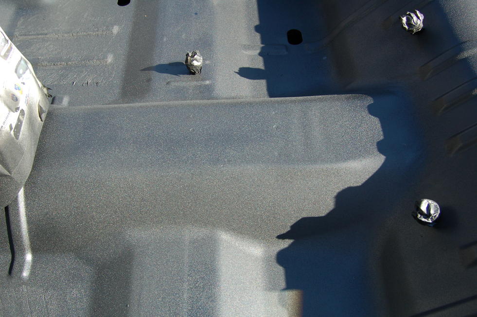

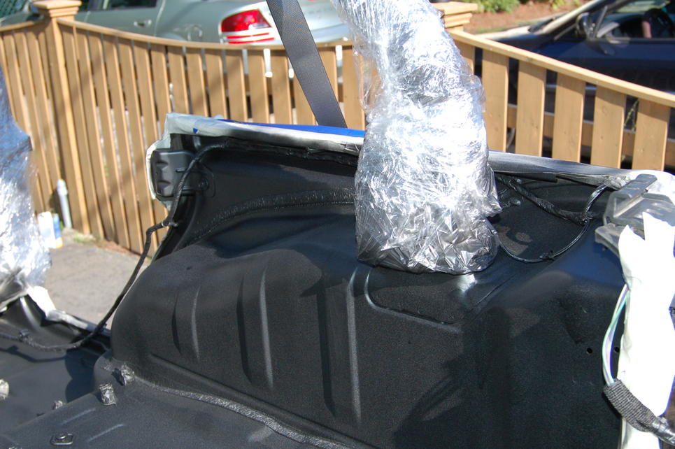

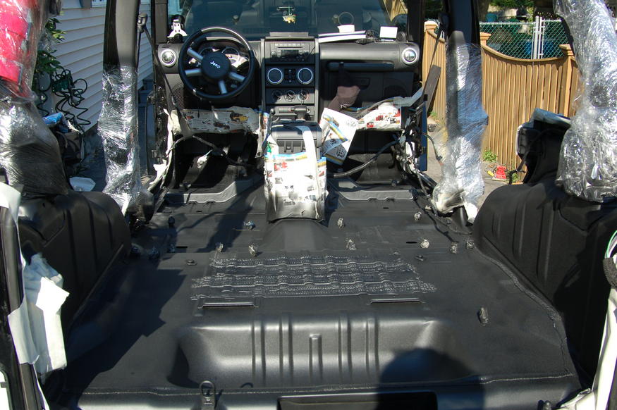

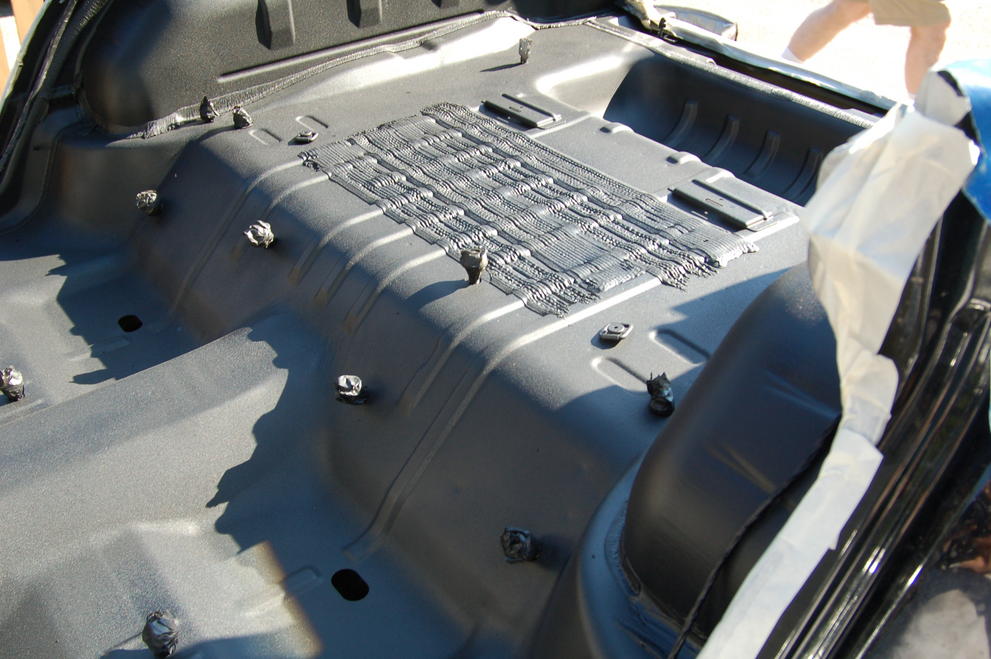

I didnt wanna pay $500+ for bedliner, so i took everything out myself. taped it all up, sanded it and removed the heat shielding and sprayed it with Rustoleum bed liner. Been over a year and still holding up great
