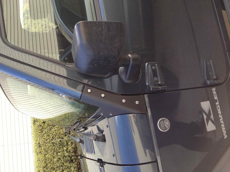

I found my windshield brackets were rusting, so I pulled them off, sanded them down, and bedlined them with Duplicolor rattle can bedliner. My torx bolts were beginning to rust a bit as well, so I grabbed some M8 stainless steel hex bolts from Lowes and they fit perfect. They are a bit longer then the stock bolts to allow for future light brackets as well.
Sorry about the rotation, it's a normal iPhone photo, but the forum seems to be rotating it.

Looks very nice! How long are the replacement bolts?
