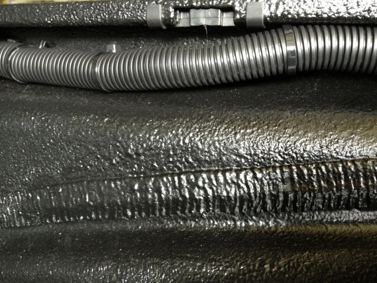

I did the monstaliner and rolled it on. Here are some pics to compare with roosters. I will tell you that a friend of mine did raptor liner at the same time I did mine and his painting time was less than an hour where mine was like 5 hours.
