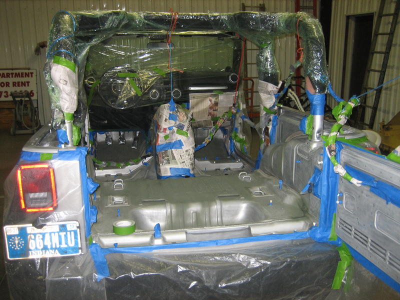

PREP
SCUFF PAINT

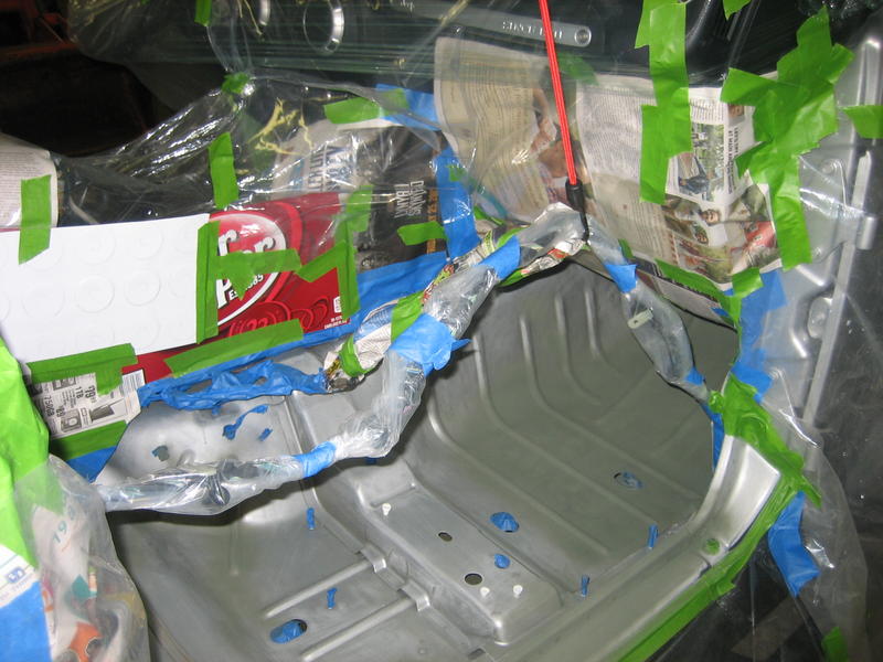

I used 120 grit sand paper. I tried one of the sponge sand pads and it was trash. I wouldn't use sand paper lower then 100. You don't want to go down to bare metal if you can help it. You want to get rid of all the shiny clear coat and then stop. The factory primer the best surface you can paint on. You can use a higher grit but it will take all day. Another option is to get a red scotch-brite pad. *I ended up finding them at Ace hardware after I was done spraying. I used them later when bedlineing my grill and they worked great.
If you do go down to bare metal use one coat of self-etching primer spray. Try to keep it mostly on the metal. The etcher part isn't great on paint. I found that out after I sprayed mine.
I just used a bungee to keep the wire out of the way. Some people have disconnected it back by the tail light that lets you put it out of the way a bit more. Plus then you don't have to mask all that wire.
I was going to remove the center console but I found out you have to remove the shifter knobs (LINK tips for removing the center console). I ended up taking off a pannel on the back of the center console and removing the 2 - T30 bolts near the back. That allowed me to hoist up the back about an inch to spray under there. If your going to totally remove the console there is no good reason to take this panel off.
You can see I used some golf tees here to fill holes. I have also hear of ear plugs being used. For the gas pedals you might want to use the sacks sliced bread comes in. Probably a plastic groceries sack would work well too tapped tight. I had some skinny bags my soft-top shipped with.

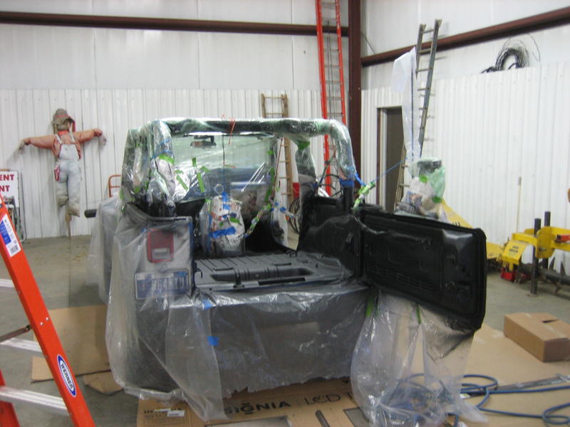

TOP RAIL
To do the top rail I masked very tight the bolts that hold the hard top on(see above-taped in green). The rear bolt I slid out. Later I had no problem putting those back ones back in, or installing my hard top.
Also I put some masking (green tape) underneath where the soft top attaches(hard plastic tucks in).
When the hard top is on the top rail is totally covered. It basically over laps it so I don't think you would run into any leak issues unless you went crazy at the seam with a pressure washer. Even then I would doubt you could get more than a drop in.
This wire that runs to the tail light can be disconnected. To remove the tail light just undo the 2 inner most screws (top and bottom). The outside screws just hold on a trim piece.
Where I masked the roll-bar to here was a bit low. I would take it up about another 2 inches. Where I did it comes out to be almost exactly where the roll-bar cover ends.
RAPTOR OVERSPRAY
The overspray was about like a rattle can or less. Not really all that bad. It doesn't hover in the air. I would put a cover over all the paint anyways, dash, and half way up the roll bar. There is very little chance it would get up by the speaker bar. I would recommend using plastic drop cloths for the big areas. They have them at lowes you can get in 9X12 in 3 packs ($5.50). While I had some plastic to use, I would think about 2 of those 3 packs would cover most of the big areas. Cutting up trash bags would probably work better then tons of newspaper that take a lot of tape to apply.
There really wasn't a whole lot of overspray as you can see from these picture
TOP RAIL
RAPTOR OVERSPRAY

http://www.youtube.com/watch?v=Fbb5dD98b5s&feature I'm super glad that I took the leap. It took FOREVER though. It's a major project for sure.
I would try to break it down into chunks if you don't have vacation time to give to it
- First week remove the carpet and the goop
- Then maybe do some sanding another weekend. I really think that it is important to get the clear coat roughed up good for it to last long and not peal off. It takes a good amount of time to really get it done well.
- The masking itself took me about a hole day. I think I over did it being that the over spay isn't all that bad but I would still do it that way again just to be safe. The spraying takes about 3 hours and then removing the masking takes about another 2 or so. I think all this could be done in one day. Then after you get done just try your best to resist the urge to put stuff back in for a day or two. I put my seat in a day after spraying and it knocked off one of the super small bumps. I ended up using a permanent marker spot to cover it up.
Being that it's the summer I have the doors off and the windows out so I really don't know. It's not way more noisy or noticeable to me. Edit: I just put my hardtop back on. I would say that it is a touch more noisy. No were close to as noisy as turning the ac on. Just a bit more engine noise and very faintly I can hear the rear differential. It sound about like someone left an I-pod playing through headphones in the back. It's not real loud but noticeable with windows up, no ac, and no radio.
