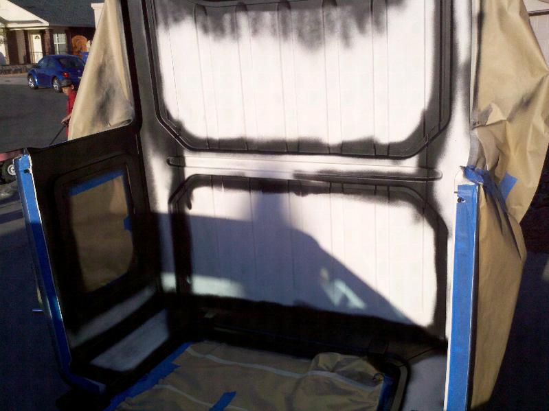

i only painted the inside of my top.. and used the duplicolor truck bed liner.. i just used a piece of sand paper and roughed up the inside then wiped it clean with a rag and water.. let it dry.. taped off my windows with newpaper and frogtape (awesome stuff) then sprayed it down! one coat! if it scuffs off just touch it up.. very simple and cheap

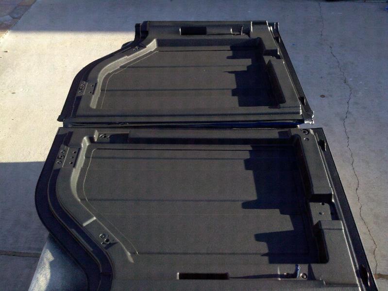

Yeah did mine this past weekend. So far looks great.
ID:	143435   Click image for larger version
ID:	143436   Click image for larger version
