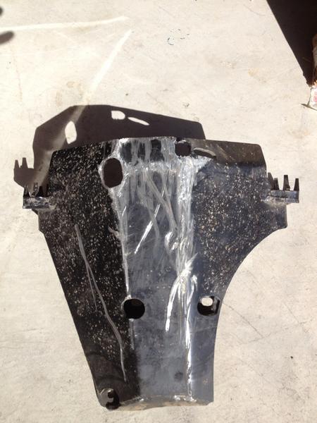

One suggestion I have is to add a N'th (AEV) rear diff skid plate. It is well worth the $189 to protect the rear diff if you rock crawl any. This is mine after running Liberty in Colorado last Saturday. Can you imagine what the diff would have looked like without this?
Name:	Skid Plate.jpg
