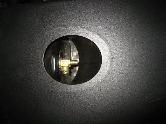

Don't know why the Rock Hard wouldn't work with anything other than a long arm. I have an aftermarket front drive shaft, but the stock should clear just fine (except for when the boot hits the transmission). No difference between the two door and the four door for that.
Here's a shot of my Fumoto valve tucked up behind the Rock Hard skid. Get the nipple version. Just connect a 3/8" hose and open the valve. If you want peace of mind that the valve will not accidentally open, just put a hose clamp on (like in the photo).

I have run all my airplanes with quick drain valves and they get abused (vibration and heat) a lot more than your Jeep would. Plus they appear to be much more vunerable than the Fumoto one you picture and they have NEVER leaked or come open. Pretty slick to have one on a land rig....never thought of that.
