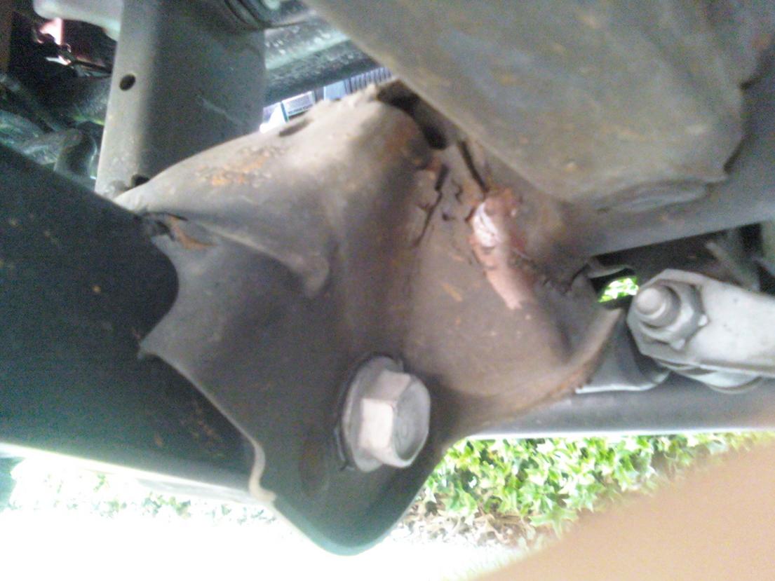

I was in an accident and bent a lower control arm bracket,smashed in pretty bad. Are there aftermarket brackets available, and can I buy them from the factory?

Thanks for the link. It says to use adjustable control arms with these. I may need then anyway.

I bought one for my Rubi from the dealer after I bent my drivers side bracket in an off road incident. You have to make sure that you level off the old welds on the frame so it will line up right when welding on the new one.
