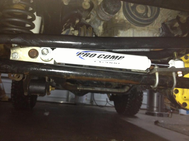

So I bent my steering stabilizer last week wheeling. So I have a few questions. Is there anything I can do to move this up a bit... I have a 4 inch full traction lift. Also is there really that much of a difference between the steering stabilizers? Any advice would be good.
Kyle

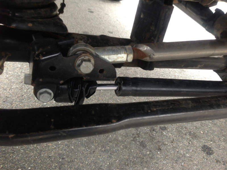

I just replaced mine with a jks relocation bracket and tie rod mount. It can either be a weld on or bolted on.
When you weld on the JKS version it also beefs up the track bar mounting bracket considerably.
