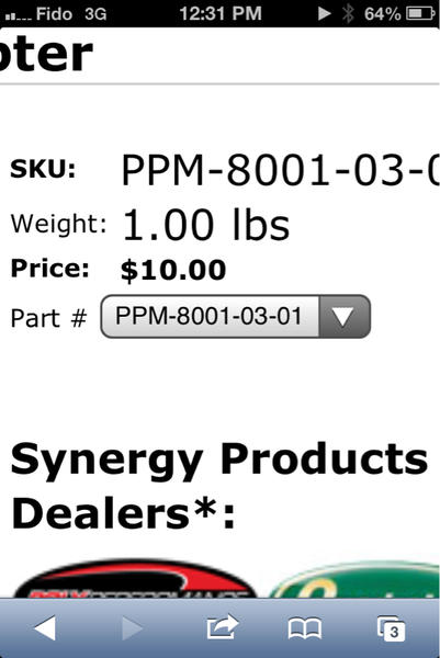

I went with a jeep jk right hand drive draglink and rough country raised trackbar bracket. Did the synergy 13/16 sleeve. Love this set up and have been helping a bunch of friends install it on theirs.
Soon to be changed a bit on my rig with an artec truss and trackbar mount, and finally putting my reid racing knuckles in that are high steer rdy. But the current setup works flawlessly.
