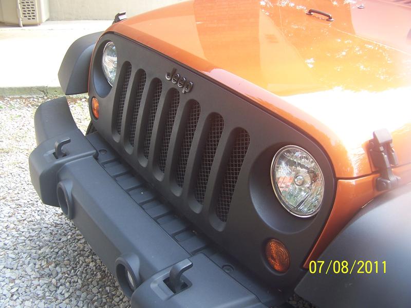

Old Jul 20, 2011 | 08:20 AM
TURTLECON's Avatar
Posts: 5,192
From: REDONDO BEACH, CA
Works great. Plus touchups are wicked easy.

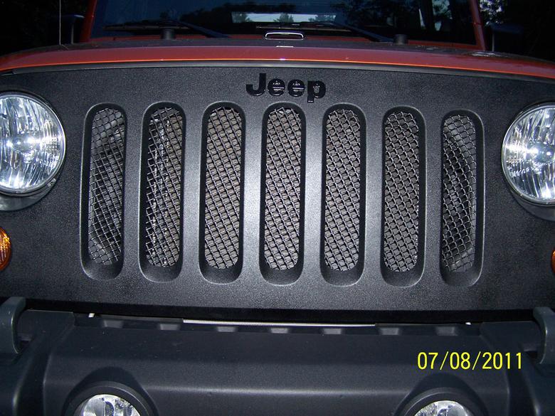

I used the rustoleum bedliner. I'm happy with it so far.
