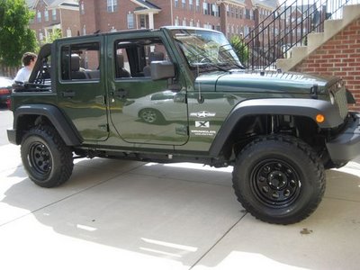

If you have 3" of lift than 35's should fit, depending on the lift brand. (Post a side picture of your jeep)

Here's a side view of my JK. I don't have any closeups of the wheel/tire combo right now but can post when I get a chance.
