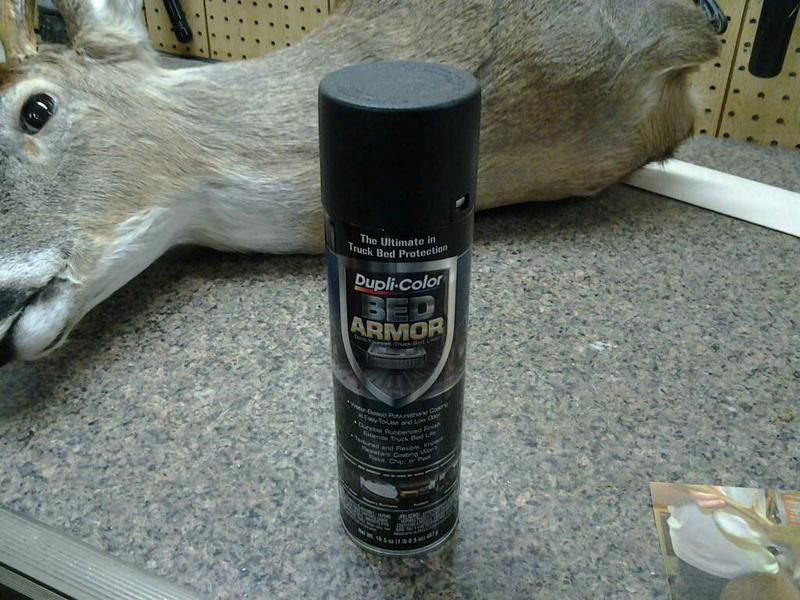

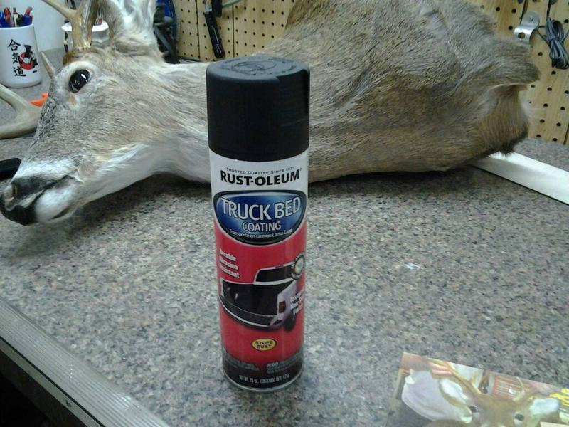

Just scuff the bumper up and don't waste your money on "rhino liner" buy thisClick image for larger version
ID:	464328or thisClick image for larger version

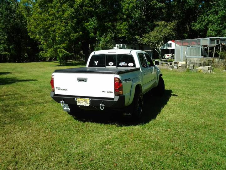

I used the first one on my dad's brand new bare steel AllPro bumper, took about two weeks to fully cure but WOW I can hit his bumper with a hammer and not scuff it! It's around $12 per canClick image for larger version

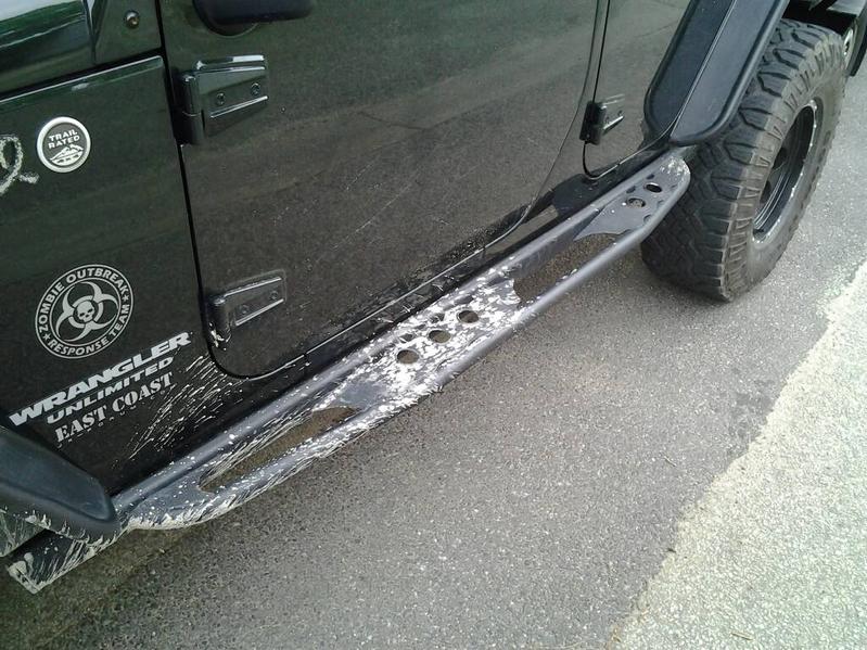

For $6 per can u can get the rustoleum, I use that on my Rubi rails once a season Click image for larger version
Just make nice even passes with the can of paint! Good luck!

I used the dupli-color bed liner on my rims.
I have 2 cases of rhino liner sitting around though I need to use it at some point.
The RhinoLiner actually cost the same. Its $25 per bottle ($100 for 4 in a case) and you get more volume than 2 cans of the rattle stuff.
