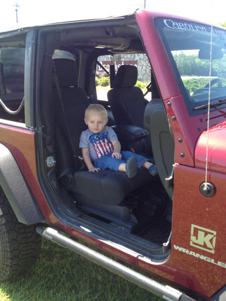

Yeah the only reason they got that many coats was we had some still left in the bottle and didn't want to waste it so just kept spraying until I ran out. But I'll try to get a photo
Don't mind my son, but if you zoom in you'll somewhat see the passenger rear flare

Originally Posted by RavenZ33
Attachment 464494
Haha, hope that boy as a little rideable toy jeep.
Looks great from the pic. Did you just do the outside or did you get underneath as well? Also, it didn't gunk up at all in the crease where the flare meets the body? 3 coats seems pretty thick to fit in there without getting on the paint.
Side note, i said rhino liner earlier I meant raptor liner.
Yeah I swear my sons brain is in the shape if a jeep. But when spraying the raptor liner, it gives a spatter effect but still covering what you are spraying. It's not as thick as you would think. But I only sprayed the outside of the flares.
