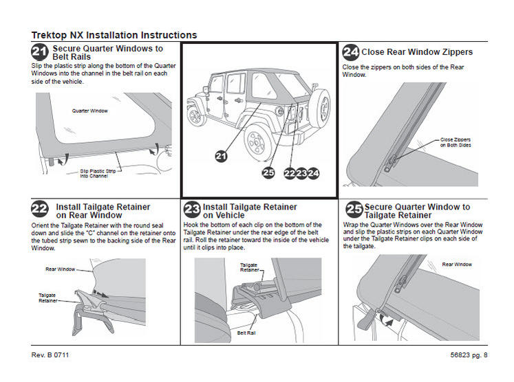

The next day was overcast and about 70ºF at the time of installation. I figured this would be warm enough and couldn’t wait to get the top on. The first couple steps went really smoothly. The installation guide was pretty good, and I was able to follow the pictures and text for the most part. (Some instructions could have been a little better worded and pictures improved, but I am an engineer by profession so that is me nit picking… I have come across much worse!)
I encountered my first problem during install step # 17 & 20. The rear side window panels were hard to insert into the door surrounds. They would go in, but not want to stay in towards the top, took a couple of tries, but nothing too hard to figure out. Once I got it, I shut the rear doors to lock in into the groove. In step #20 the zippers were really hard to fully close; requiring substantial pulling force… not a big deal, but this worried me somewhat about the rest of the top.

The next step I had trouble with was the #23. The step requires you to attach the tailgate bar to the rear tabs of the vehicle. Initially it appears that something was seriously wrong as there was a good 2 inches between the tailgate bar attachment clamps and the sheet metal tabs built into the body panel of the jeep. At this point, after some thought, I decided that I should loosen the rear bow brackets which dictate the position of the rear window and top of the assembly. These brackets have some play front to back and if I positioned them too far forward, it may be causing the problems attaching the tailgate bar. (These brackets can be seen in install step # 2 and #13). By loosening the brackets I was able to eventually get the passenger side of the tailgate bar attached and with the help of a friend I was able to get the driver side attached… but something seemed wrong. Should it have required the strength of two to get this attached to the rear sheet metal attachment tab??? The zippers of the rear window were eassly closed and life was good! Almost don’t with my install!
Or so I thought…

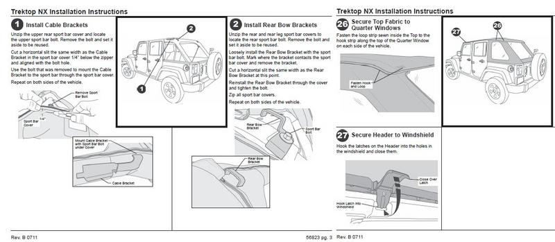

Step #27 would prove to give me even more trouble! When the top of the cover was flipped over to complete the installation, I noticed there was a noticeable gap between the front window seal and the front of the trektop nx top header. I tried to reach the factory attachment bars on the front window assembly with the hook levers attached to the header of the trektop nx and was no ware close… we tried everything we could and the hooks were still too far away from the latches… finally we thought we should loosen the brackets in step #2 a second time to try and get the top a bit closer to the front in order to engage the lever hooks into the attachment bars on the front window.
This finally worked and I was able to clamped the top down to the front window!

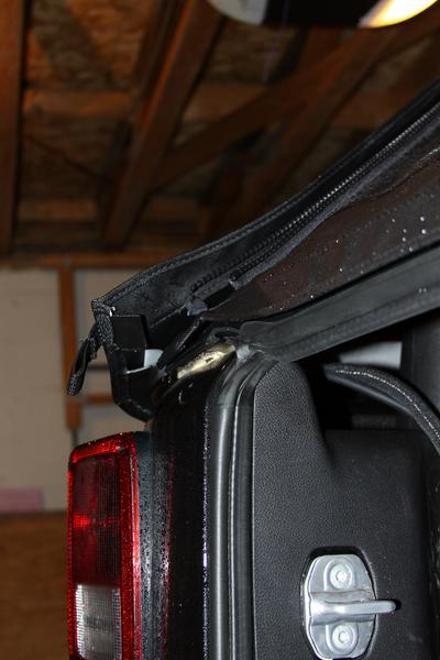

The next day after work I was walking up to the jeep and I noticed the rear tailgate bar looked strange on the driver side…
Upon a closer look I realized that the tailgate bar had actually bent the sheet metal tab upwards as seen in the pictures below.

I called Bestop and they said they have never heard of this problem before with their Trektop NX’s and usually have the opposite problem, where the top is too loose and people call to figure out how to make it tighter!
The Customer service people were really helpful and kind. They asked me to send in pictures of what had happened. I sent the pictures yesterday. I will update you all on their response to this damage.
I have also taken the jeep to the dealership to see what they had to say about it. They think this may be covered under warranty somehow… well see, I find it hard to believe Chrysler would cover damage caused by an aftermarket product… but I will update you on that front as well!
Have any of you have similar problems or similar experiences? I really like the look of the top and hope I can find a solution to this problem.
