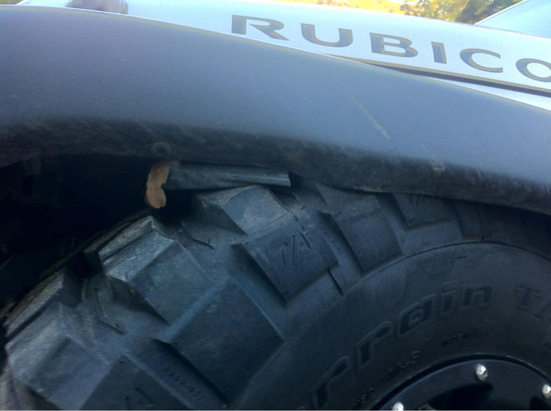

CerOf's Avatar
Joined: Apr 2009
Posts: 1,331
From: Dallas, TX
Originally Posted by Dano646
Thanks for the info everyone. 33's are in the plan and it looks like it's not a big deal.
You'll rub if you disconnect. Even with a leveling kit.
Old Feb 2, 2013 | 08:32 AM
Dano646's Avatar
Joined: Mar 2009
Posts: 41
From: Michigan
Originally Posted by CerOf
<img src="https://www.jk-forum.com/forums/attachment.php?attachmentid=417219"/>
That doesn't look. What is the minimum lift to avoid this rub when disconnected?
