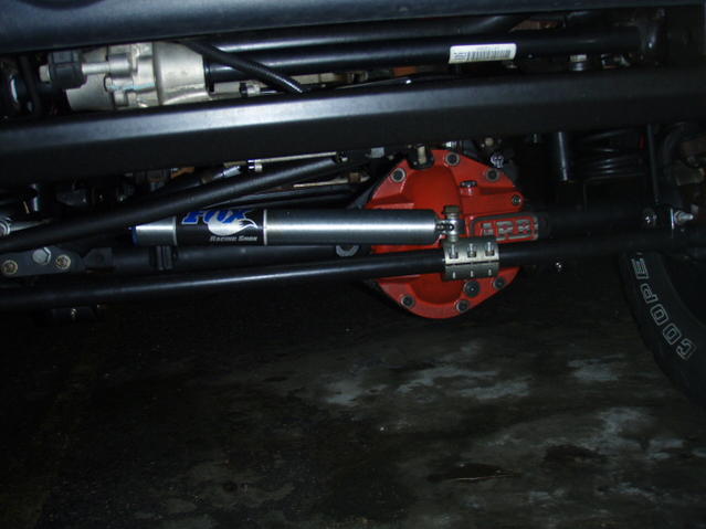

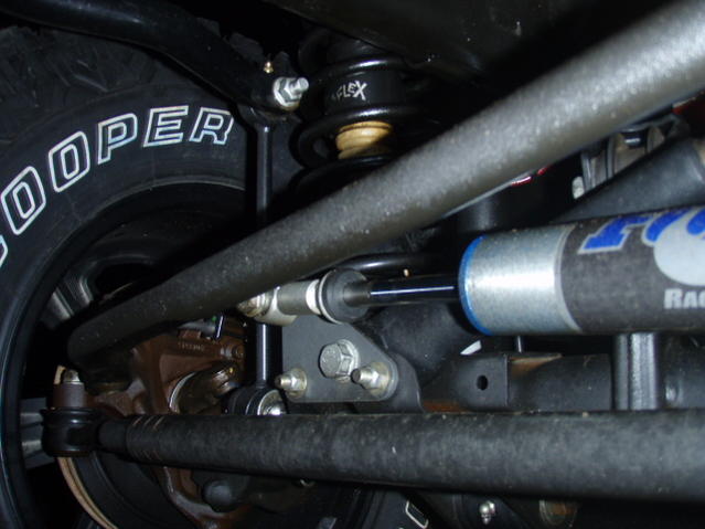

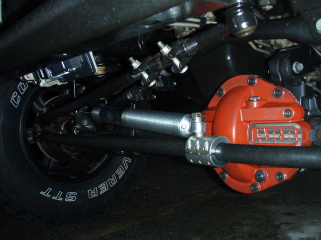

I have a Fox SS. I haven't heard any issues with this SS. So far everyone I know on this forum has no complaints. I do have a RC dual SS new in the box. I decided against it after I bought it because I don't like how it has to be installed. I feel that with a hit to the tie rod big enough may cause the axel to bend as well. Look at the pics any you'll see what I'm talking about.

did you check the ss that you have installed? examine it to see if it did blow out. also, make sure you have it tightened down. If you upload a pic, we can see if it is installed incorrectly.
Sorry for the night pics. Its the best I have for now.

Any comments about how my SS is installed in the pics that have been posted?
