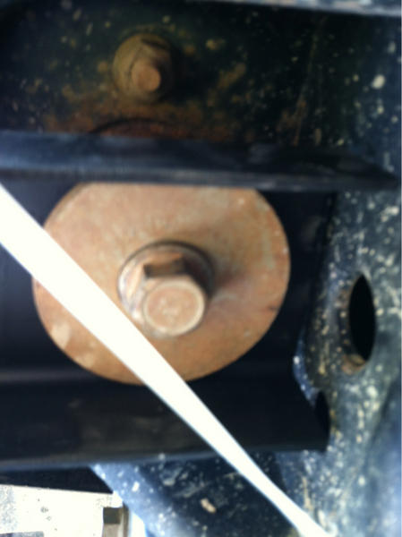

Old May 23, 2012 | 08:52 AM
jkkrawler's Avatar
Posts: 781
From: prospect,pa
Don't mind the zip tie but that bolt won't thread in or out
So I am guessing you are out for Scrubbgrass this weekend?
Sucks man- Can't see an easy fix.
You could grind the bolt head off with an angle grinder and that would let you remove everything out of the way. The bolt probable threads into a clip nut that then can be removed and replaced. Make sure to wear proper eye protection if you grind it off such as a face shield. Metal grindings in the eye is not something you want to experience.
