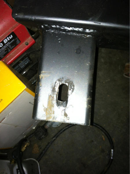

Well good news I got the bolt free. I feel like an idiot but when I got home took it straight to the garage unbolted the front one and it popped right out. But now I can bolt it back in with no rail but as soon as I try to mount the rail the bolt feels like it won't quite reach the threads on what ever is up there. My driver side went up fine and the front bolt on the pass goes in fine. But like I said in the beginning I bought these homemade so the bolt that I'm having trouble with has a 1/4 in piece of plate welded on the mounting bracket on the rail. None of the other ones have this so I'm thinking I should grind the welds off and pull that lil piece of plate off. What does any one else think?
The one with the plate and what all the other 3 look like.

just weld the rail on. A shop should do it really cheap and wouldn't take to long.
