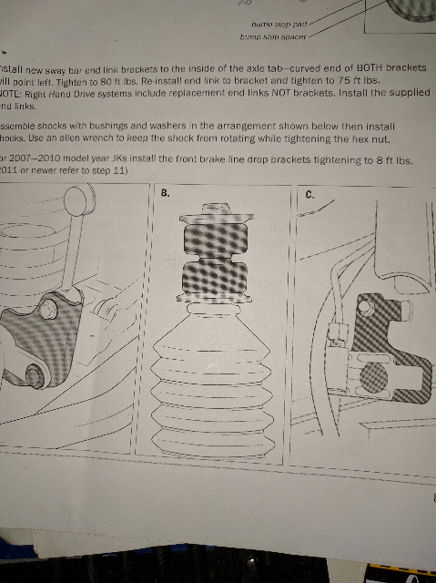

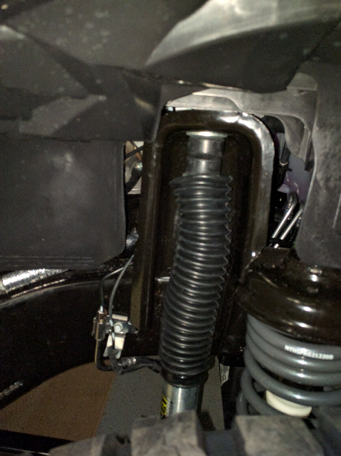

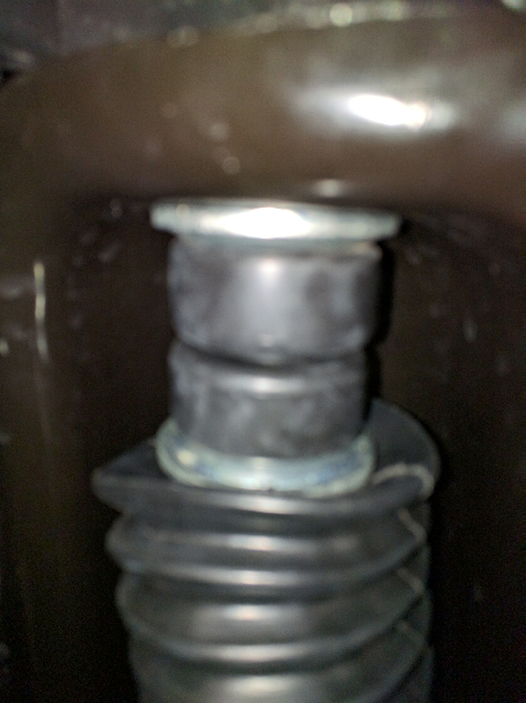

Here are pics of what is going on. The threads barely stick through the top without and washer etc even on top yet.
ID:	647181   Click image for larger version
ID:	647182   Click image for larger version
ID:	647183   Click image for larger version

it will go just put the rubber bushings on right and it will go. just get one thread going and the bushings compress. I just did mine so fresh in my mind.

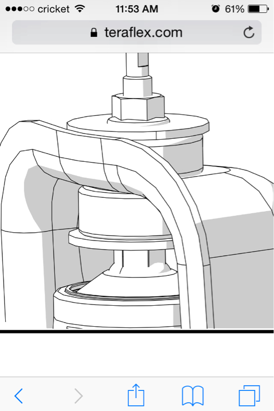

Looks to me like your only supposed to have one rubber bushing. I'm not sure about that brand but the TeraFlex Fox shocks don't have huge rubber bushings like that. I'm sure someone on here has put those on. I'm wondering if something is wrong with the shocks.
yours has two rubber bushings, one is on top of the shock mount and one is on the bottom. he is just trying to show the thickness in relationship to the stud. He has the right bushings.
Old May 15, 2016 | 09:32 AM
Jonathan_JK's Avatar
Posts: 2,203
From: Jacksonville NC
Ok I see... How bout just using the old bushings from the old shocks? I mean it's just a piece of rubber.
