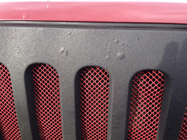

Kind of surprised my grill mod using Duplicate-Color bed liner "bubbled" after about 6 months. I was meticulous in the application process. I sanded, used a primer, then applied 3 coats of liner. No problem for the first 4-6 months or so then this. Any thoughts?
Attachment 499164
I don't know really what to say except maybe the primer didn't go on right , or something between the bedliner and primer
I have been using dupicolor liner since 2009 and I have never seen a bubble , I also have never used primer

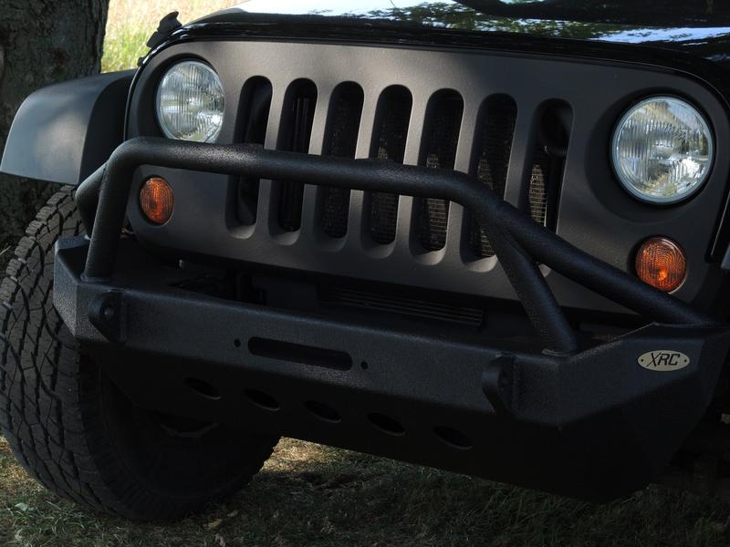

Here's mine...
ID:	499290Click image for larger version
I sanded the grill down with 100grit so there was nothing left shinny. Then washed the grill with dish soap and water. Rinsed. Let dry. Then wiped the entire grill down with denatured alcohol.
Then, five light coats of Duplicolor Bed Armor. Let the coats dry for at least an hour before spraying the next coat.

After 'bedlining' my door hinges and the mirror for my mirror mod (sand blasted these), I figured out that the spray goes on pretty thick if you're not carefully and humidity played a BIG factor in drying time and needs a good clean surface to stick to.
Wanting to do the grill mod... I read all I could find on the different ways people were doing their mod as well other mods using bedliners. So, I read and watched Duplicolor's videos on their Bed Armor application.
So over all, I am very happy with how the Duplicolor Bed Armor turned out on my hinges, mirror and grill.
