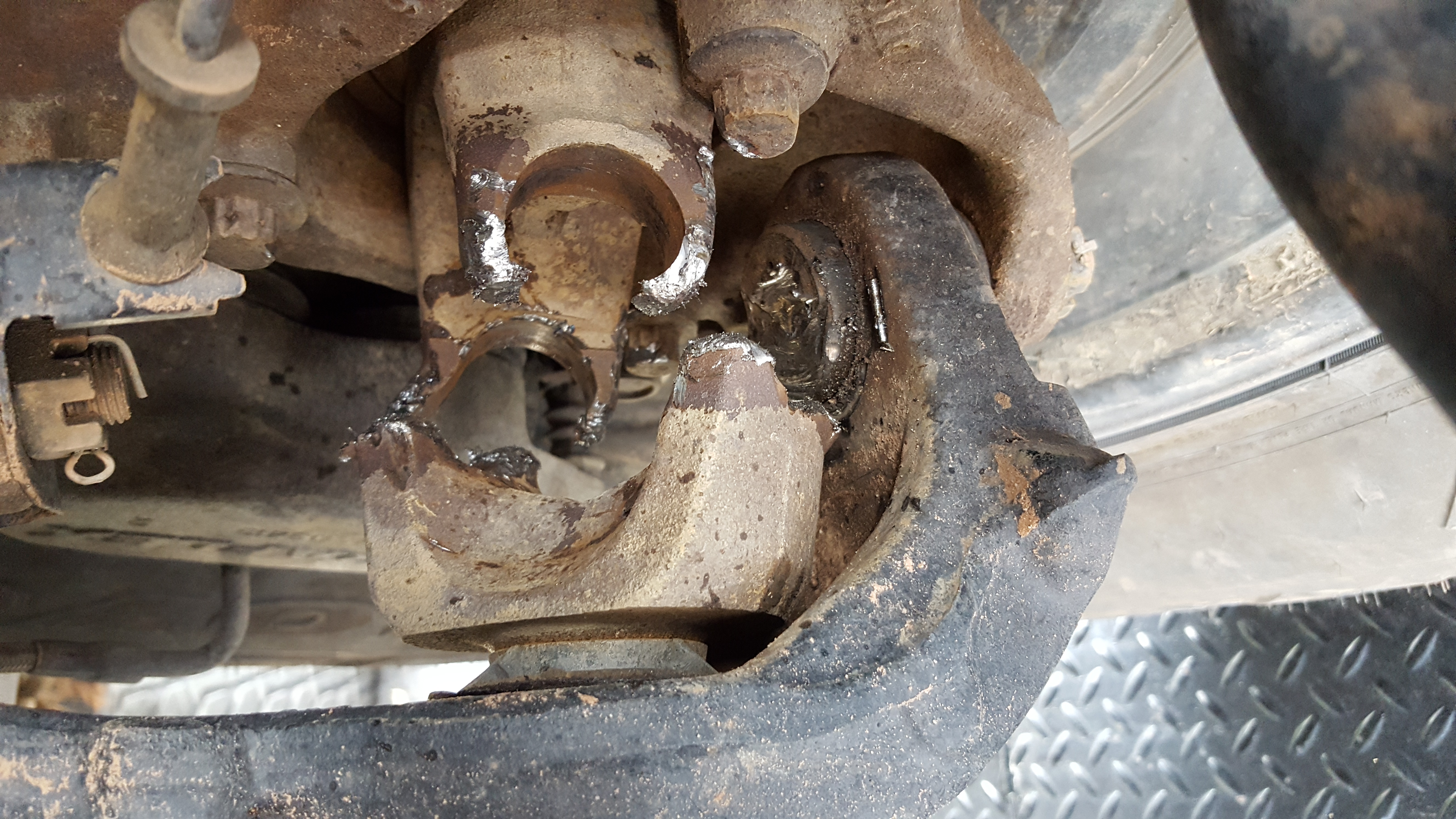

After closer inspection and disassembly, I found that in the process of the joint breaking and the U joint ends hitting each other caused the TF ball joints to be completely unseated. The top joint was pushed out over 1/8 inch and the bottom joint was driven down so that the top of the joint was even with the surface of the C.
So, I have removed the joints because they had to be replaced anyhow. I will be welding on some gussets and installing new Synergy ball joints. I am also going with the chrome molly shafts instead of RCV's.
I wanted to improve the strength, but couldn't yet justify UD60's.

It probably isn't that common for folks that remove the axle shafts immediately on the trail. However I still had about a mile to go with no other way out after hamburger hill. There were 3 more significant obstacles I had to surmount with no bypass available. I did those in 3 wheel drive and some much needed winching. I should have pulled the shaft there, but it was getting late and I didn't want to be stuck there over night.
So I went back to look at the photos that I took. They were taken after getting it back on the trailer. The first shows the gouging that the U-Joint did to the top of the lower joint. It looks to me like it is still mostly seated, but maybe a little at an angle. In the second picture you can see that the top joint is slightly ejected and the grease boot is completely compressed by the knuckle.
Close-up Lower Ball Joint.
Upper Ball Joint.
When I was disassembling it, I noted that the lower joint was even further displaced and the top of the joint was completely flush with the C. It didn't stick up at all into the C. What I am having trouble figuring out is how the lower joint moved between the time that I put it on the trailer in MOAB and getting it in my garage in VA.

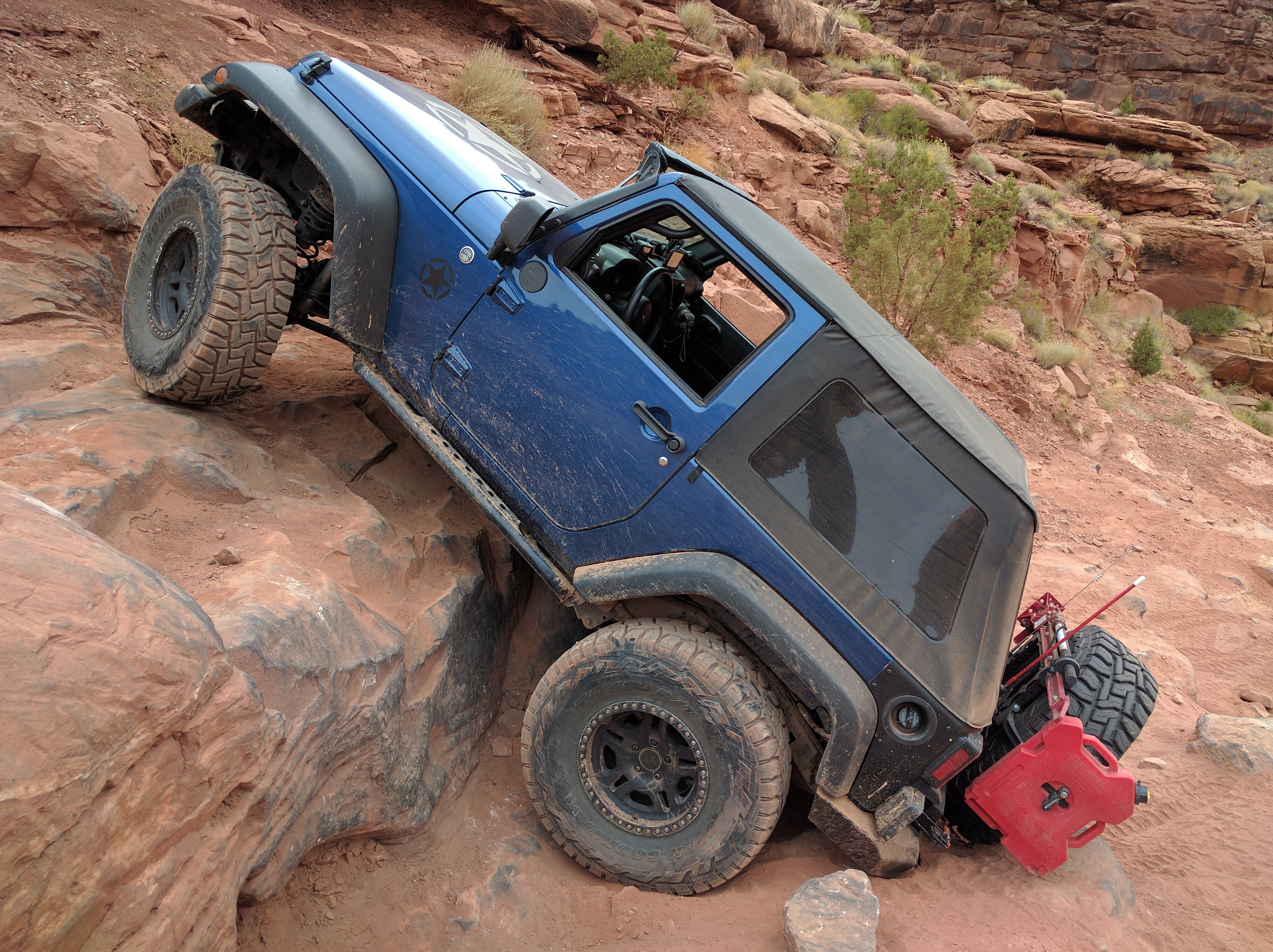

#5. Keep your recovery gear where you can always get to it. No matter what... In the photo below you can see that my Jeep is basically sitting on the spare tire. I keep all my gear in the back in one of those Smittybuilt security storage drawers. When I got out of the Jeep to survey the situation after killing my axle, I instantly saw the problem. I couldn't get into the back to get my recovery gear unless I could open the tailgate. Normally I would have winched myself up the hill, but since I couldn't do that I had to grind on it some more to get down from my perch on top the rock.
