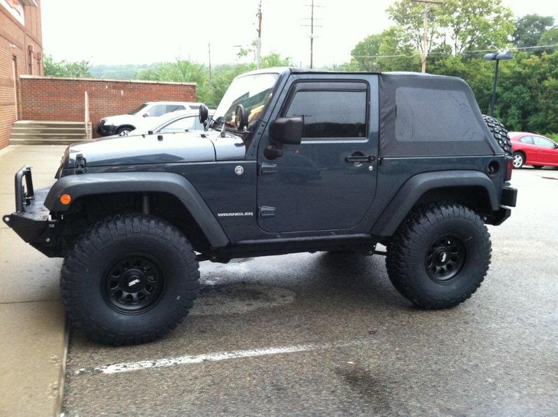

I have the extreme rails. As prior poster noted you have to drill into the side of your jeep and use RivNuts. That was Pain in Backside and resulted in drilling two rivnuts out and replacing them. Seems there should be some sort of butterfly bolt that would work better. They have held up well. There have been no issues with them. They look nice and they are stout. I have used them as high lift jack point with no issues. That said. If I were to do it over I would have went with something else that didn't require drilling into the body. By drilling into the body I am now "married" to these rails unless I want to do some body work.
