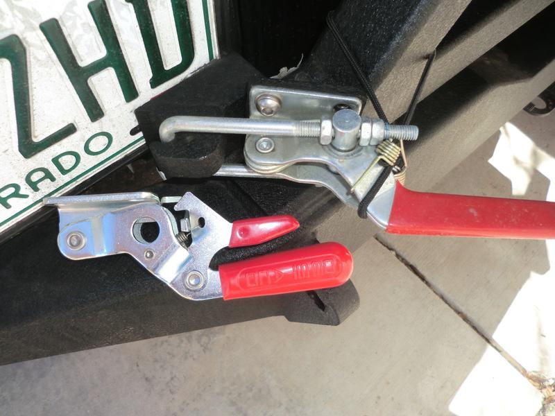

Below was my 2nd temp fix (small bungee) because the 1st temp fix with the hitch pin didn't work (it kept tailgate from flying open but the latch still would spring open after bumps or whatnot).

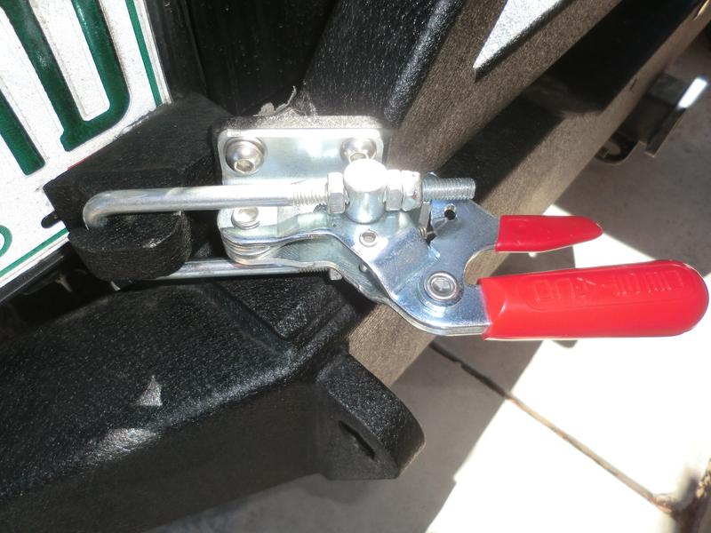

The Destaco 341-R's handle is a little shorter but the bolt holes line up perfectly.

It took just a few minutes to attach.
