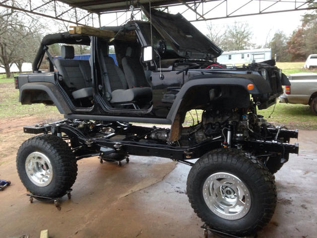

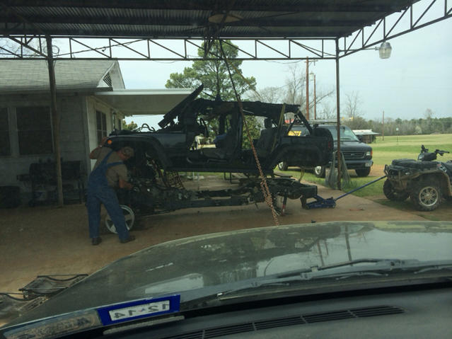

I went to Aev website for hemi install instructions and they have a downloadable step by step guide to hemi install and first part is all about a checklist of things that have to be disconnected for body removal prep. Took a day to do the prep and then next day i rolled jeep outside and connected upper roll cage(i have the rock hard sport cage so it has alot of extra bracing in the area that i lifted on). For the body removal, i didnt have a hoist so we used a snatchblock and a chain connected to friends jeep to lift the body off and that worked but went too fast, so for body reinstall i purchased a harbor frieght manual hoist and used it and that was much better for nice slow controlled decent. The first pic i showed u was the hoist putting jeep body back on. Here is the pic of it being removed just for giggles. Wheel dollys are invaluable during reinstall to wiggle the frame into position.
