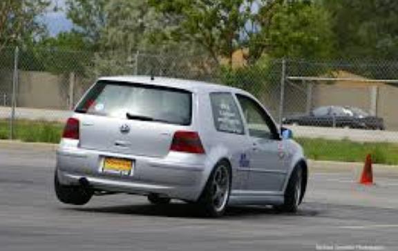

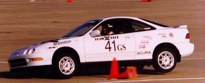

Results of swaybars set too stiff thus little to no torsional resistance/spring to keep the wheel planted...

This is what happens when you're in a high center of gravity vehicle with large/soft sidewalls and improper swaybar (and even suspension) tuning. Notice how improper tuning causes inside wheels to lift. Doesn't take much to roll these vehicles over even at slow speeds. I would hate to see a vehicle like this in a Moose test aka lane change test like the Cherokee was submitted to. We're not even talking extreme setups (swaybars pointed 89* down) or extreme driving here.
