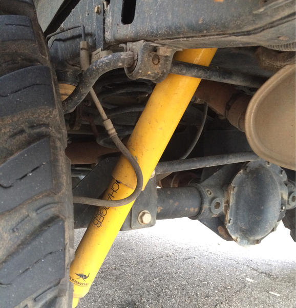

Here's my rear sway bar for reference

Old Apr 14, 2015 | 05:43 AM
sea bass's Avatar
Posts: 998
From: Enumclaw,WA
Originally Posted by TaylarsJK
Yep I do. Do you also have the MC sway bar drop brackets installed in the rear? I'm not sure if sway bar angle affects body roll or not
I have the MC longer links in the rear. Angle might have some affect but not much I wouldn't think. Are you sure it's body roll that you're experiencing and not the flighty steering of improper castor?
Old Apr 14, 2015 | 06:05 AM
TaylarsJK's Avatar
Posts: 569
From: Tallahassee, FL
Forgot to include that I have AEV control arm brackets too. They're in the 2.5" hole, I could set them at the 3.5" hole if that would help. I was going to anyway, but need to find ratchet straps to help line up the holes.
