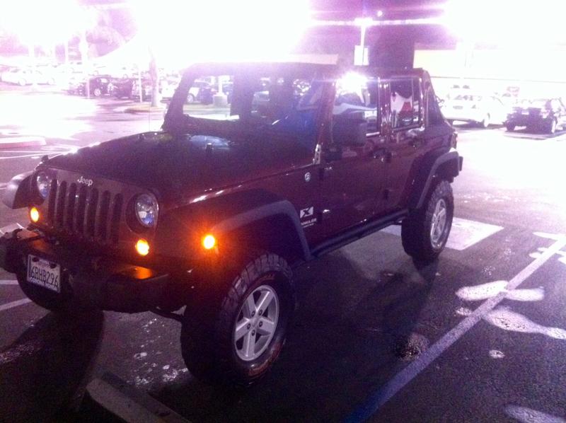

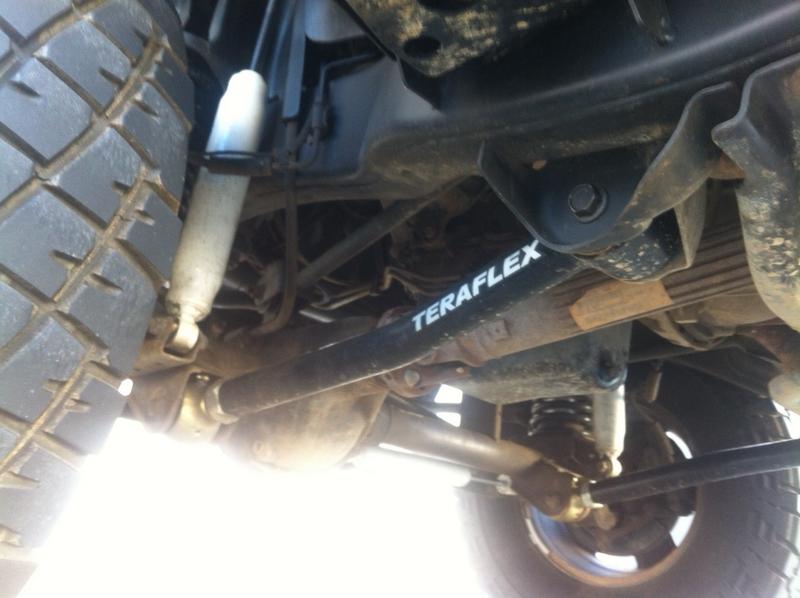

I bought my 2nd JK last night and it is already lifted , looks as it has been geared and also has banks ram air.
I would like to get superchip flashpaq for it and was wondering if i need to know the gears and if i do, how do i find out? the dealer was a hinda dealer and had no idea what was done to the jeep so i got a pretty great deal.
Any info will be helpful. here are some pictures
Thanks in advance!

This may be off topic but get some longer brake lines if you disconnect your front swaybar.
Those Terraflex lower control arms flex like mad (I have them as well), you could overextend your brake lines and well... break them!
