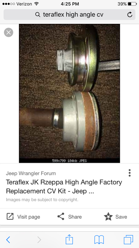

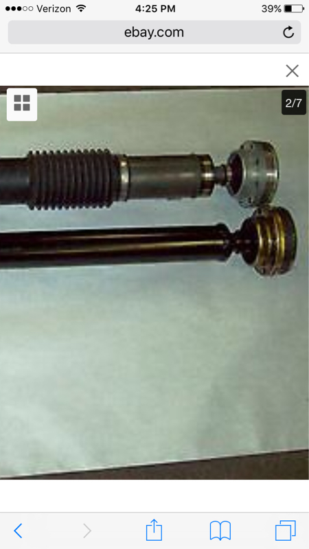

Definitely looks like the teraflex to me. I don't own it so I can't say for certain. My guess would be the teraflex and they just don't want to give them the publicity lol.
Thats my pic on right. Looks good to me ... Who whats to be the guinea pig?
