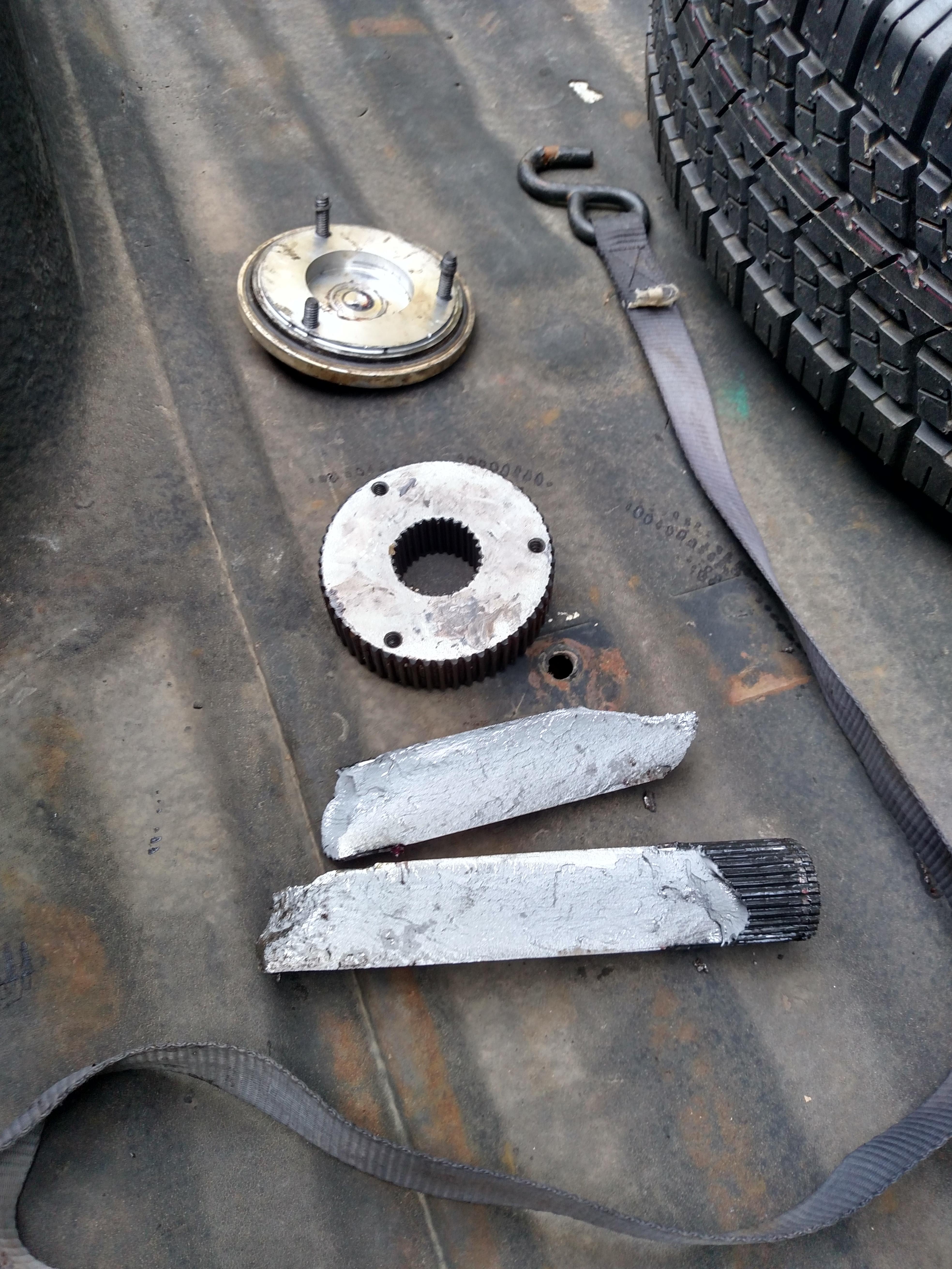

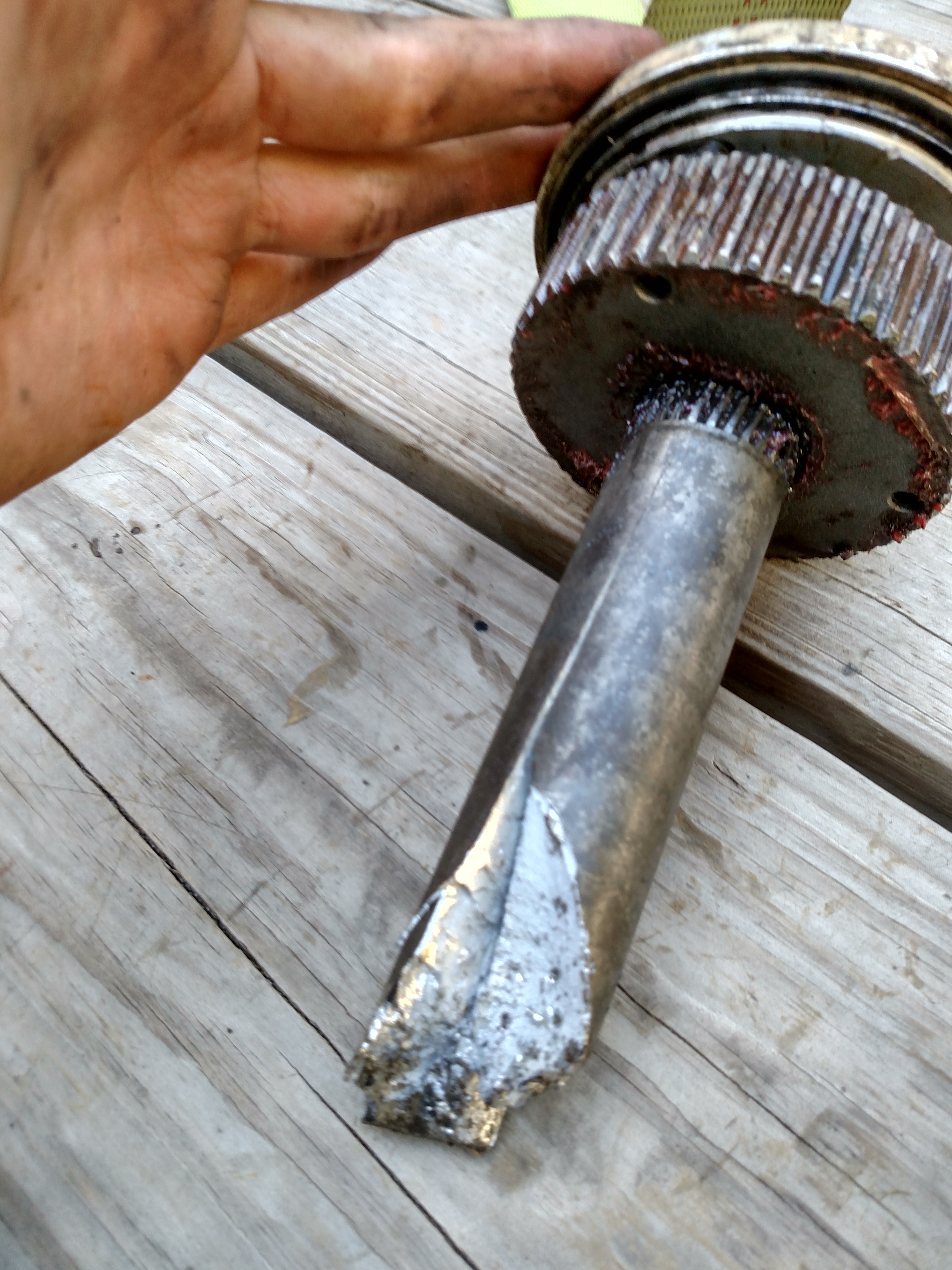

A 1310 ujoint will not be a weak point in a dana 44 or 30. Manufacturers LOVE to put the "1350 recommended for 37" and up tires" because people like to see that, and people like to "know" that they are ordering the right thing.
Here's a dana 60 stub shaft that I broke with a tom woods 1310, yea it was only a 30 spline dana spicer. You can totally break ujoints with a dana 30 or 44, but I wouldnt call it the weak point. A dana 30 will always have the tiny ring gear as the most obvious weak point.
There was no bouncing going on when it broke, just a 40" tire that was in a situation that refused to allow rotation. Simply put, a spicer 1310 ujoint took more torque than the stub could handle, multiplied by 5.38 of course.
Attachment 659797Attachment 659798
