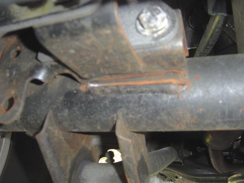

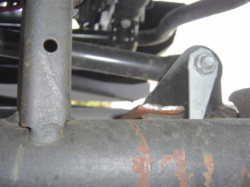

hi ,i have a broken front track bar bracket , i was just wondering what would be the best way to repair and reinforce the track bar bracket so it doesn't happen again ? what kind of weld would be the best to use ? thanks alote for the help ..here are a couple pics .

Weld or have it welded back on then use something like the JKS trackbar bracket brace to support it.

Did you break it from wheeling or on the street?

i noticed it when i was on the street, but i was doing some mild trails a day before.

You could buy a new brcket from Currie.
