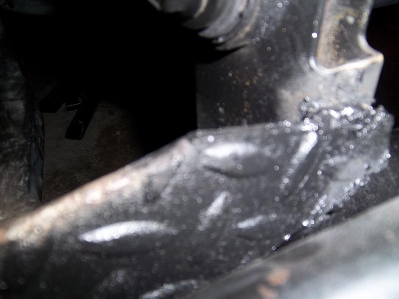

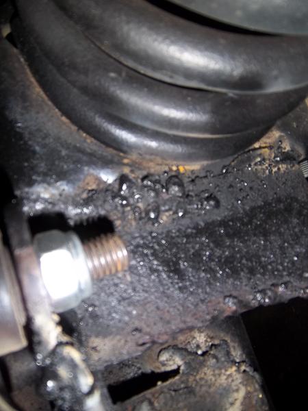

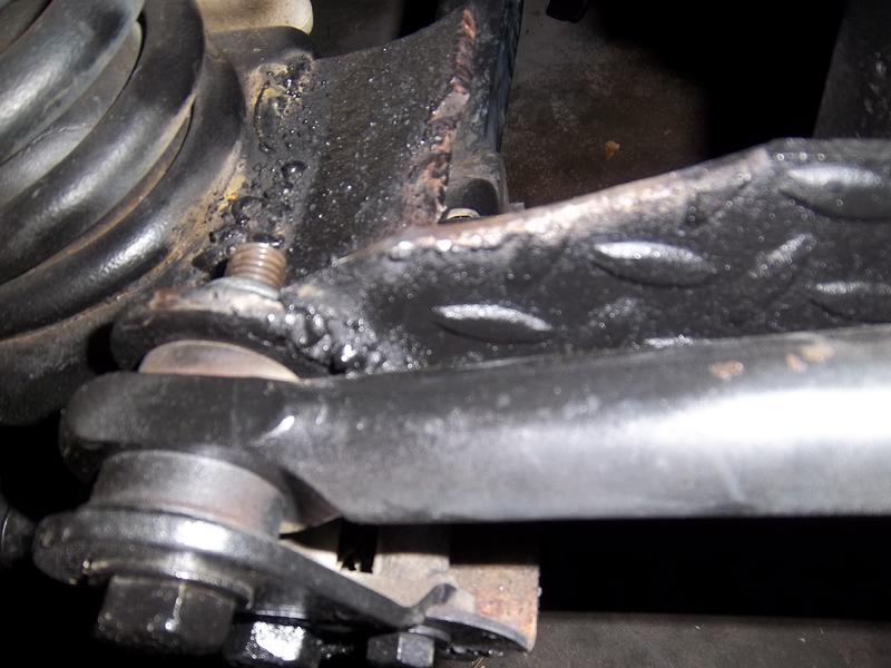

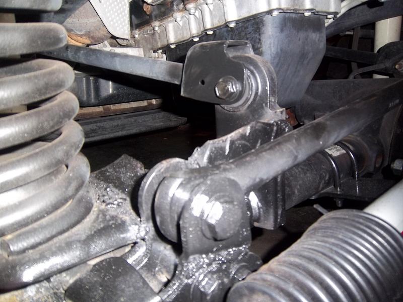

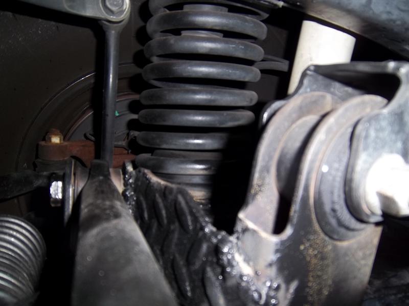

I forgot to mention how I braced it. I welded a 1/4 " thick metal brace from the top of the track bar brace to the top of the arm bracket. It's a straight shot. The bottom of the track bar bracket I welded a 5/8" thick peice of metal to the bottom the spring holder. Here are some pics that I hope help. These are somewhat hard to reach areas, to weld and photo. But I also had to weld and reinforce the broken bracket areas.
